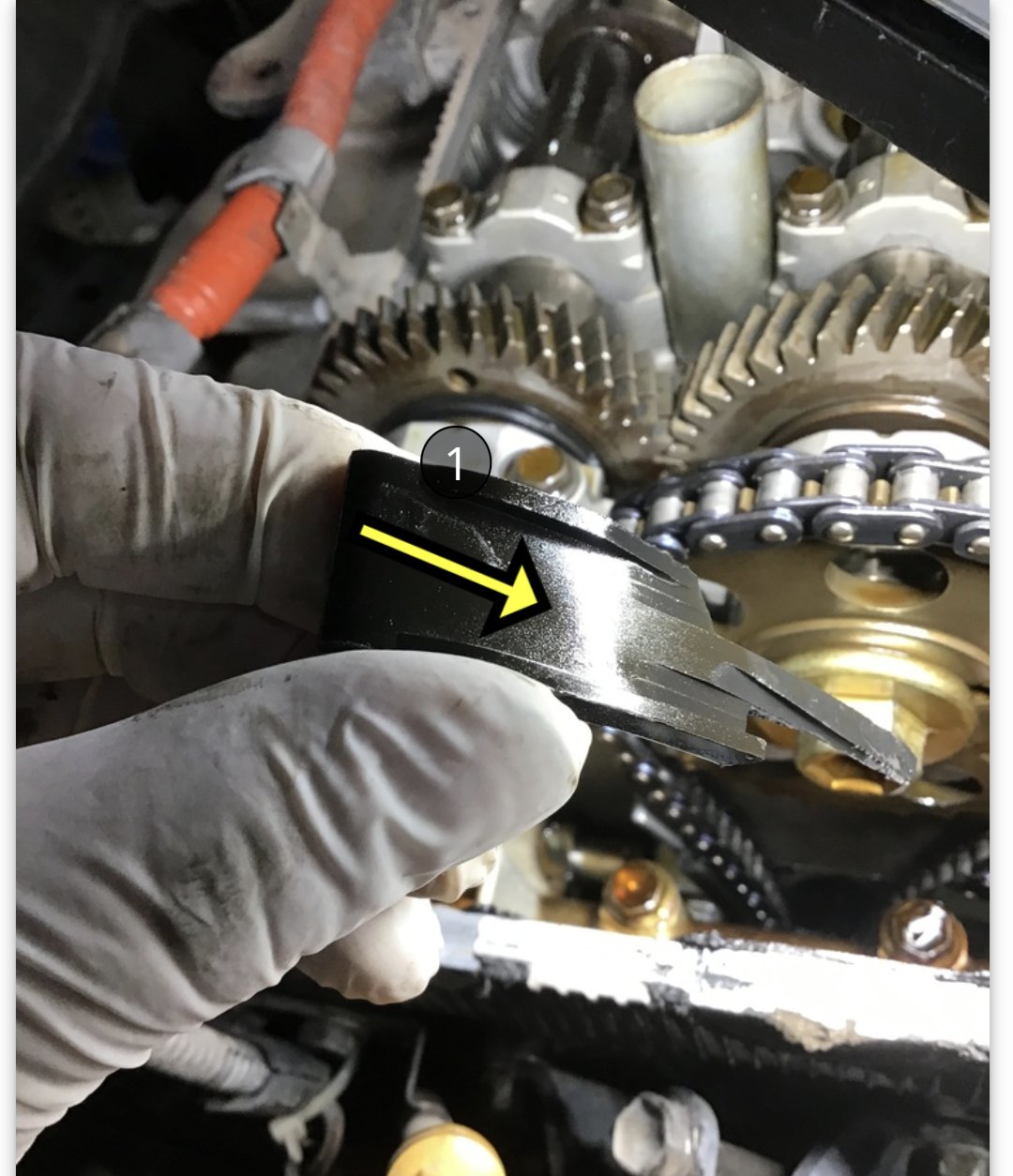

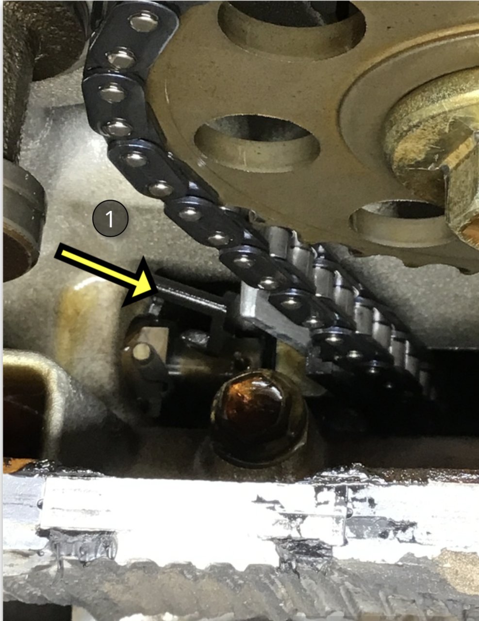

    I was getting a valve job because my gasket was leaking out the front a bit 205k miles. They said it's about a 15 hour job to replace the chain tensioner, guide and chain and they are quoting me 3k.. YMMV

    Would you replace the chain/chain guard if you saw wear?

    absolutely. is that from a tensioner failure?

    Alucab Canopy Camper BAMF HC Dual Swingout Rear bumper BAMF Sliders Westcott 1.5" TRD pro lift Icon RXT option3 leaf pack Rago HD Shackles & Hangars BFG KO2 285/75/16 CBI T3 Aluminum front bumper Warn EVO 10S Total Chaos Bed stiffeners Home built Aluminum HDPE bed platform.
    It must have been slipping at least but I never heard the ticking or slapping. I've heard it on 22REs but not familiar with it on the 2.7.

    I believe that the 2.7 timing chain guides stand a better chance against wear than the 22RE engine would. The Achilles heel of the 2.7 3RG FE is the valve train lash.
