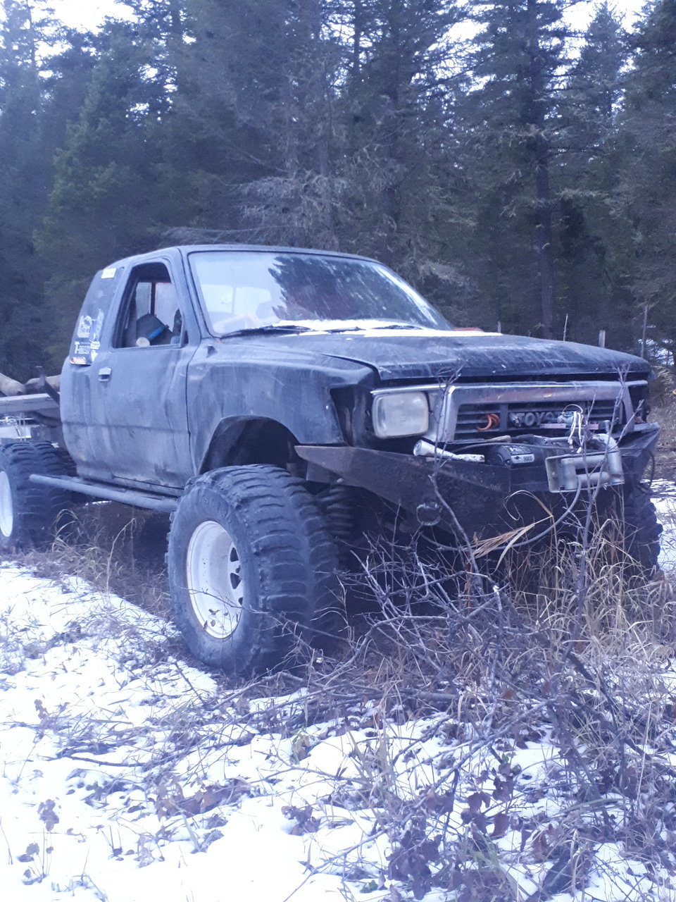

    rylan
    06 4banger taco 5speed / 90 truck with long arm, gears and lockers fully built engine
    undersized tires lol air filter box mod on the 06 anyways 33" boggers and gutted on my 90 yota
    Plain Jane Taco and Pigpen like this.

    So what happened to your 06? Also the 90 says fully built engine, what engine and what was done?

    06 just has low compression in #2 cylinder so it kind of detunes after 3300 rpm and losses power the bogger is a 3litter v6 all the machine work headers msd oversized valves oversized throttle body rv cam basicly everything except turbo or s/c nothing like shifting at 7 grand and maybe making 200hp lol
