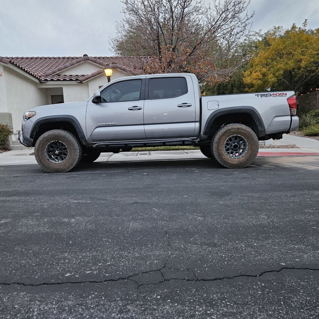

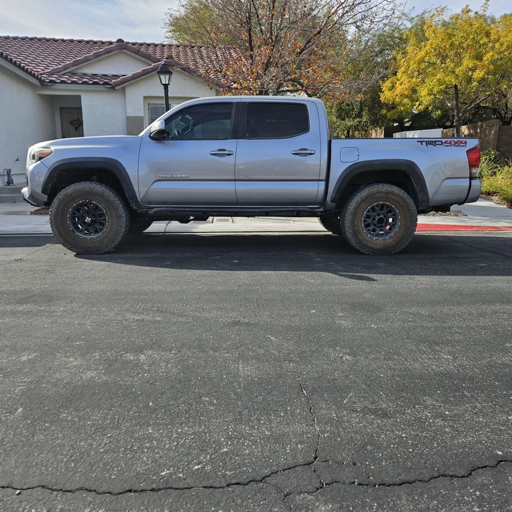

    Get General Springs HD for $400 a pair before you buy a set of takeoffs. 1.5" lift on empty bed/cover, stronger than stock, no squeaks.

    Good take on GS, a hair on stiff side unless you add weight, which will depress lift. However they are stronger than stock and quiet, and cheap. It will take a full 1/2 ton in bed to drop them an inch- I hauled multiple loads of landscape rock.
