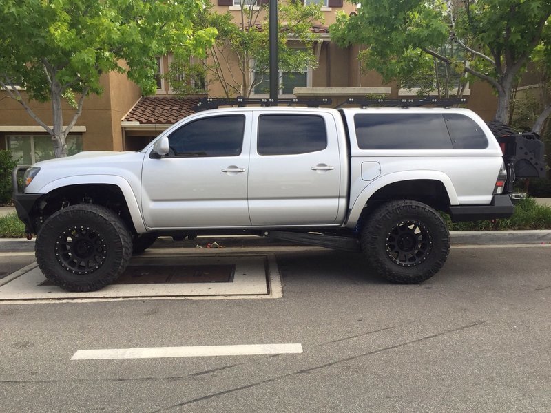

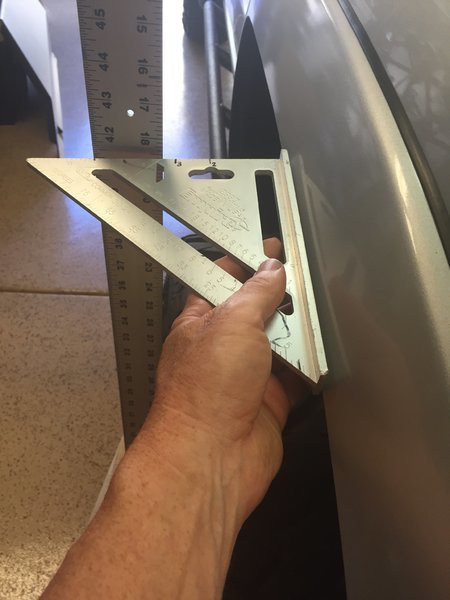

    Working on it guys, trying to nail down all of the " wants " and cosmetic ideas before we go in for the actual first mock up. I'm PM'ing lots of folks but please keep posting feedback here in his thread as I start showing the ideas.
    Working on determining the amount of flare / wheel coverage to create that will translate well for many different set ups. IE: if we were to build a fender flare that fully covered a 35x12.5 on a truck with a +2 kit then the flare probably still look o.k with 35's on a stock width kit but would look silly with any tire size less than a 35. I mocked up a few examples yesterday and would like to hear opinions because again the idea here is to build a one size fits all flare that will satisfy everyone from 285's and up including +2 kits.
    All of these example were taken with my personal truck that has a Solo Motorsports +2 kit with 35x12.5's on 4.5 BS.

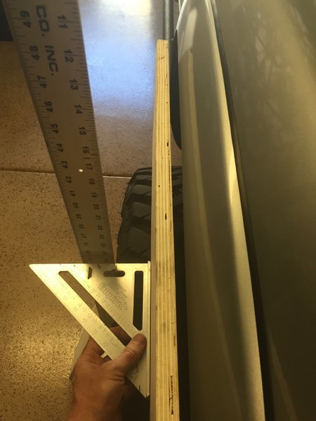

    This first photo shows 2 things :
    1. When we cut our flares for larger tire clearance we actually lose width on the flare.
    2. How far the 35 sticks out with a +2 kit = 3.5". In a lot of states this will actually get you a fix it ticket. In speaking to a few folks across the country the most common exposed tread allowed is 2".
    This photo shows how wide the flare would need to be to get back to 2" of tire poking out with a +2 kit, with a stock width arm this would be full tire coverage for a 35. This also matches the width of the outside edge of my CBI plate bumper. ( outside edge of the ply )

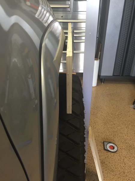

    Here is a view from the rear, a couple of things to note here :
    1. The body of the truck tapers at the front and of course at the bottom too. Simply drawing a straighter line in both directions vs having the flare follow that taper down to the rocker provides a LOT more tire coverage.
    Photos of the shape of the wheel opening mocked over the tire will be coming this weekend.

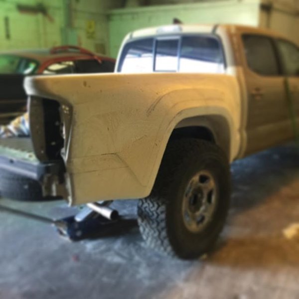

    Here is a photo of my personal truck so you can see the amount of cut out we are aiming for so the flare will truly clear a 35 at bump. These clear lock to lock up front and at full articulated stuff in the back.
    Also - working on sourcing bulk hardware I.E.: the cut out fender flares will include quality pinch molding ( not that crappy door edge guard junk ) to cover the cut edge of the fender and bedside.
    THROTTLE231, Crom, Dalandser and 2 others like this.

    2in over stock is perfect IMO. If your running a 285 with the reccomended Backspacing your gonna be almost flush with 2". It may make the tire look small but at the same time you can run less lift and it'll look more proportionate.
    Definitley put me at the top of the list for a 2" cut out flare if that happens. I really like where this is going

    Those are +4" width at least and also notice that the bedside wheel opening does not look much larger than OE
