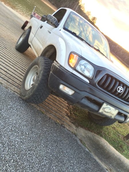

    I'm just kinda curious how bad will my truck rub with a 2 inch leveling kit and 32/11.50/15

    On stock rims youl need to do pinch weld mod. Itl rub frame at full lock but not much. Those tires will fit with no lift just fine aswell.
