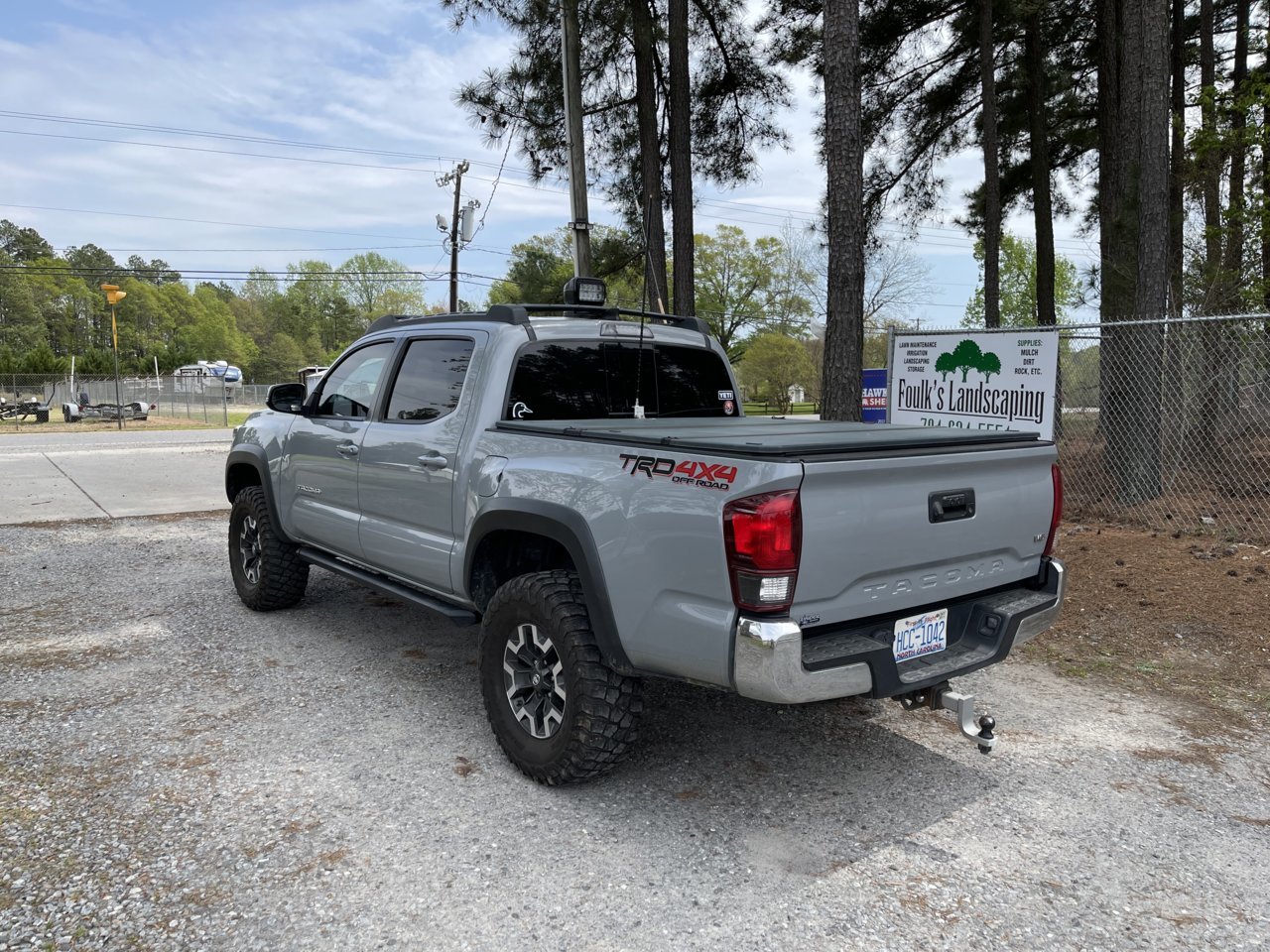

    I currently have a 2 inch leveling kit (Bilstein 5100s with a 1 1/2 block in the rear), and 285/75r16 BFGoodrich KM3s. They are on stock TRD Offroad Wheels. I was worried about them rubbing, however even at full turn they do not. I did not have to run any spacers, cut plastic, or do a CMC.

    Funny, this post is 2 years old and got revived. I did the same setup and didn’t need spacers but wanted the stance and didn’t rub until adding the spacers but rubbed on cab mount and a little on the flair. A chop fixed that.

    How are they not rubbing on the UCAs?
