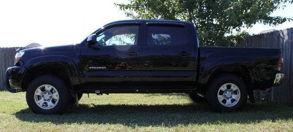

    I figured 4WD too because of AK, but can't tell from the one pic...kind of looks like a 5. :confused:

    I didn't see a pic of the OP's truck? :confused:
    Tacodatugboat has a 6 lugger.

    There is a small one in his public profile...the more I look at it though, the more it looks like a 6. My bad.
