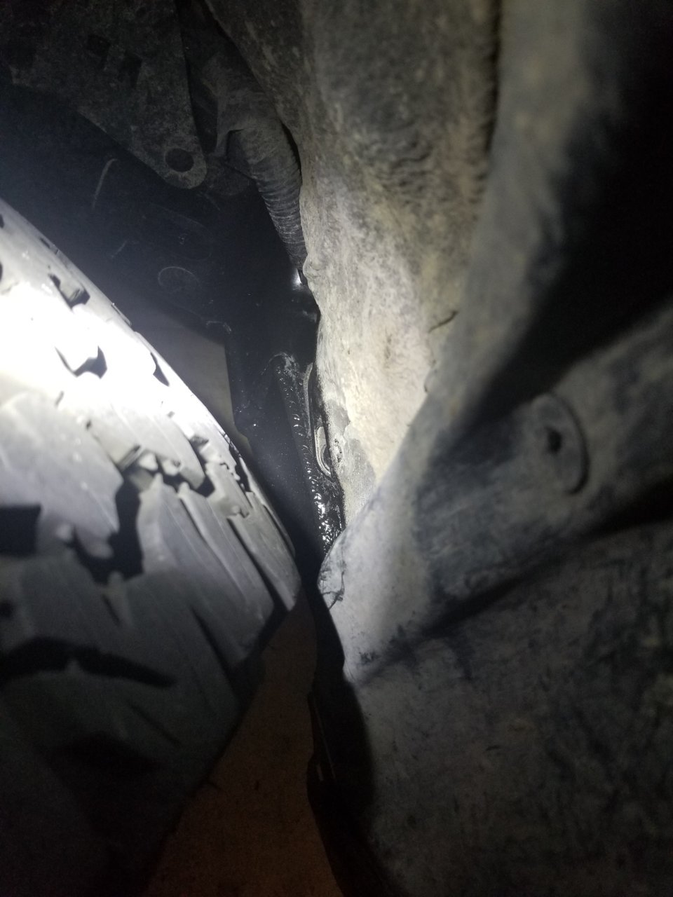

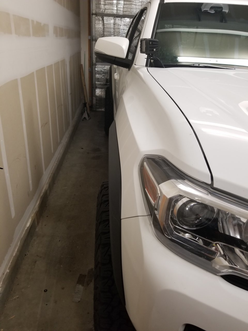

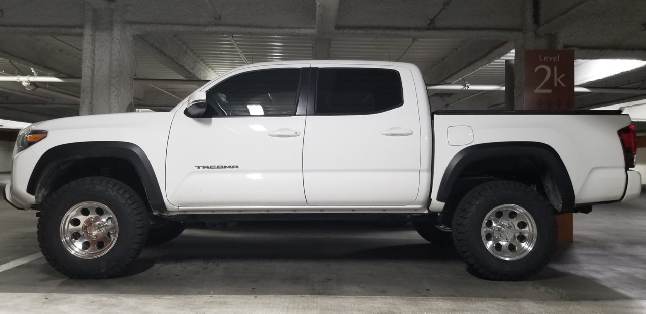

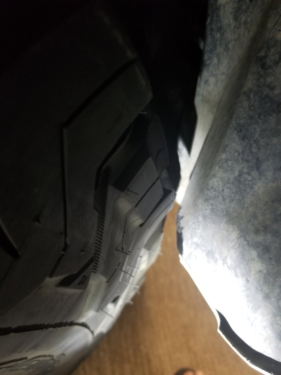

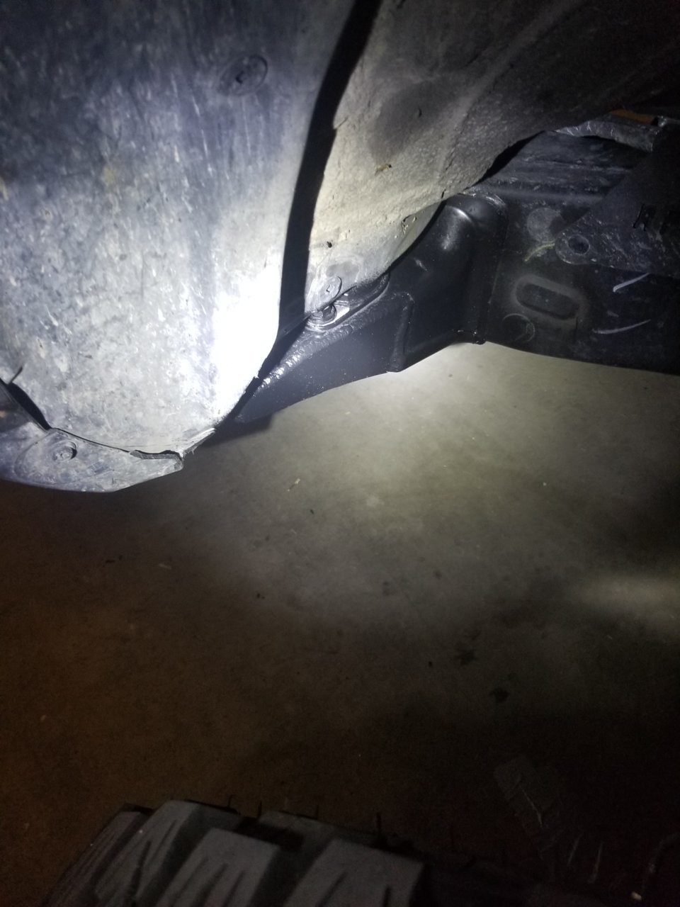

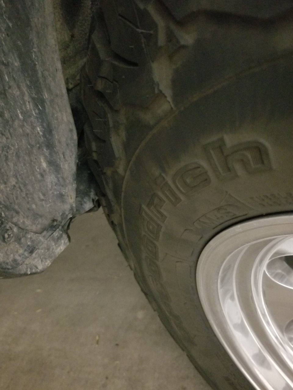

    I have a 2 inch lift with bfg 265/75r16s and 16x8 pro comps with -12 offset. Before spidertrax spacers I would rub only turning hitting bumps. After spacers I would rub in reverse badly and forward compression turning. I just got a cmc from Maximum Offroad in Vegas using Relentless Fab plates. The front still rubs a little but I can heat gun the plastic. The back is fine now. Glad i did it. Didn't want to lift the front higher.
    Before with spacers
    After passenger side
    After driver side
    Passenger front slight rub
