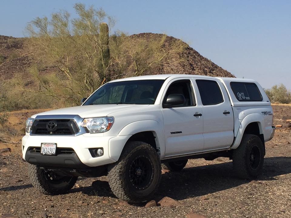

    Hi Carson,
    It is really better to have the spring lift your truck so you do not stress your shocks and you get better life span from your shocks.
    If you have 5100's set and 0 and say OME 885's on your 2013 you should get 2" in the front and it will ride great on and off road. No dipping when braking and little if no roll from side to side
    when turning. Put add a leafs in the back with 5100's and your good to go. I purchased my set up from headstrong offroad and Marie knows her stuff. https://www.headstrongoffroad.com/store/p250/Old_Man_Emu_Lift_Coils_-__Various_Lift_Heights_Available_(PAIR).html

    What kind of tires do you have in this pic ? Look sick
