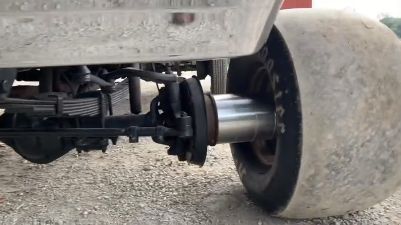

    No but this guy is running a stack of 2 inch spacers

    Would not recommend going with 2” wheel spacers. It’s going to put a strain on the wheel bearings and possibly cost you money in ball joints down the road. I’d go with 1.25” hub centric spacers at the most.

    He is on a whole different level than most people.
