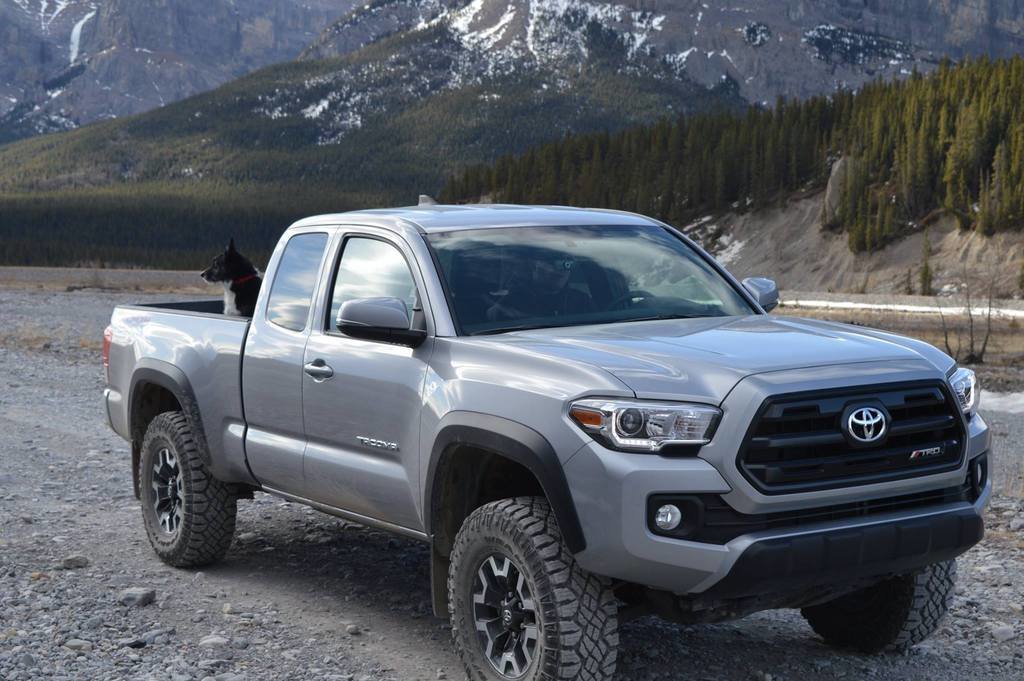

    I have 265/75r16 (same as 70r17) duras with a 2" level on my 3rd gen, 285's will rub but not much, I prefer never rubbing. the one size up rule applies to all Toyota trucks, step up one profile and don't worry about it.
    12764419_10156651903470046_1899168646597_21d1a0f6f8b24b876f8d7964647a6bd48760a0c7.jpg
    I have e's because I would have had to pay extra shipping for C's. They work better for me because I deflate really low due to the rocks we have out here. If you don't plan on doing trails or deflating I'd go C for sure.

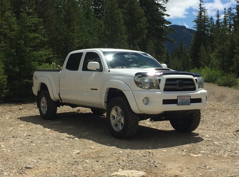

    Secondary air filter removal, K&N drop in, Removed front mud flaps, Toyota all weather matts, skid plate, bug guard. Bilstein 5100's all around fronts set at 2.5", OME add a leaf, Goodyear Wrangler Authority 265/70/17, stubby 6.5" antenna, smoked tail lights, blacked out badges.
    2.5" level with265/75/16 Duratracs

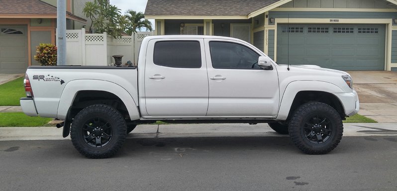

    2015 SR PreRunner Oahu Edition
    PlastiDip
    2.5" leveling kit. 1.5" AAL. 265/75/16

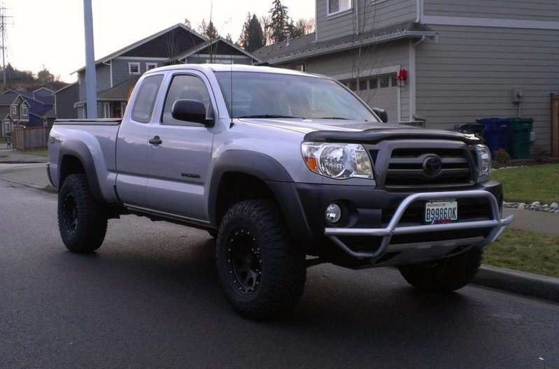

    Current setup. 265/70/17 Goodyear Authority. Bilstein 5100's around. Front at 2.5" OME add a leaf.

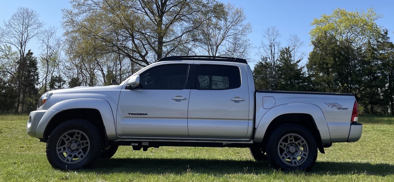

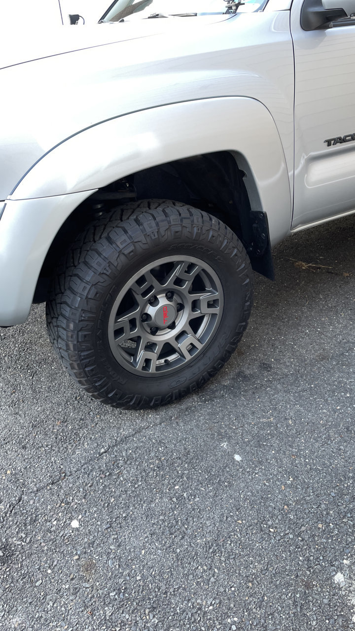

  15. Aug 11, 2022 at 3:51 PM
    TACOMA2NDGEN
    TACOMA2NDGEN Well-Known Member
    Jan 24, 2018
    #242230
    1,994
    ROLAND
    new jersey
    2010 dcsb silver sport trd
    baja squadron pros
    I had duratracs in the past. Last set on this truck and my previous jeep. Great tire but damn they get loud when they start to get low. I switched to the nittos. There about the same weight they have a great side profile witch is something I really wanted. So for about 10k on them and they are great 6B14689A-576B-42CB-A886-38AF581DD9EB.jpgF084407F-ADA5-4076-BA18-6087EA657BE7.jpg
