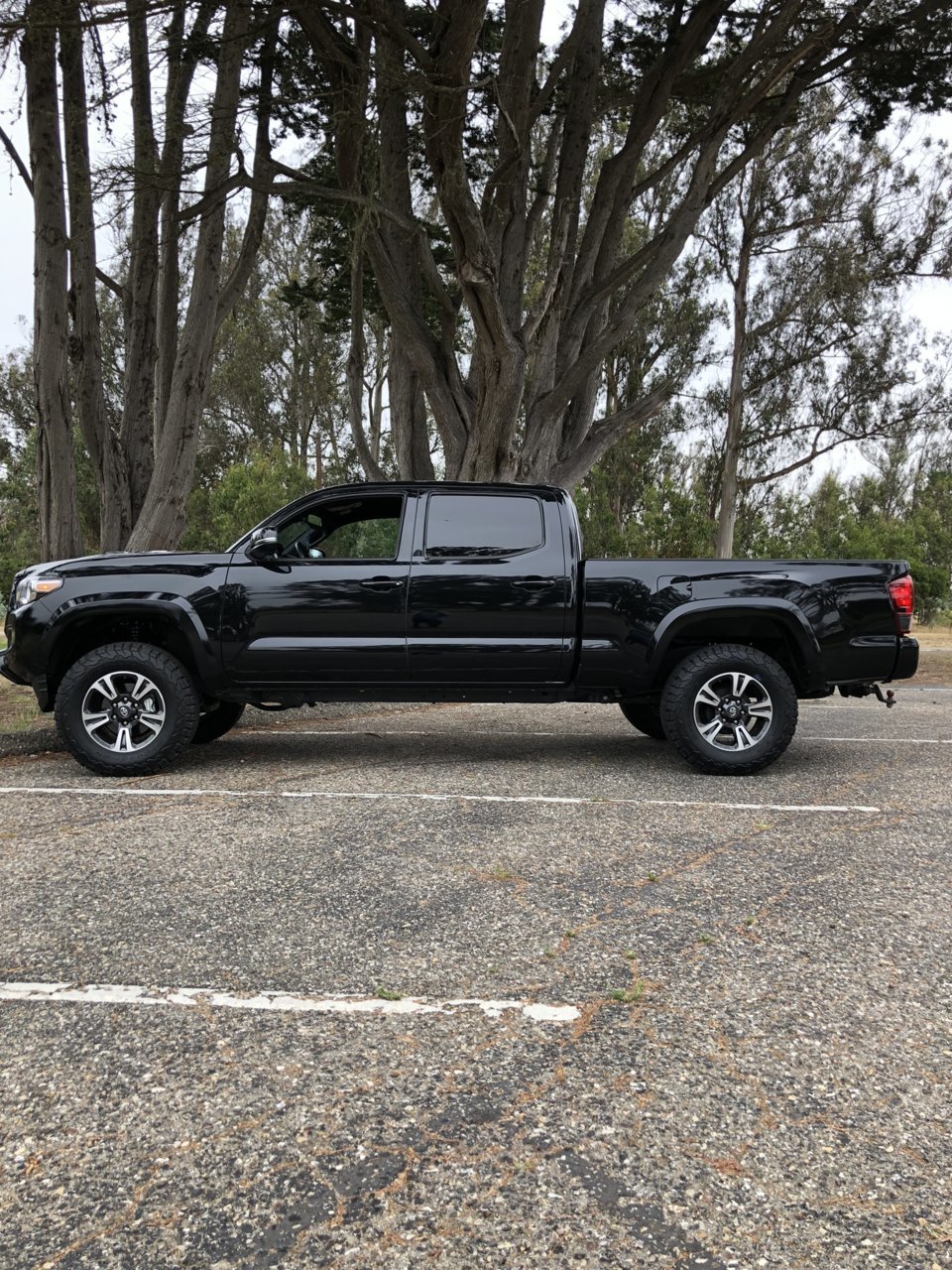

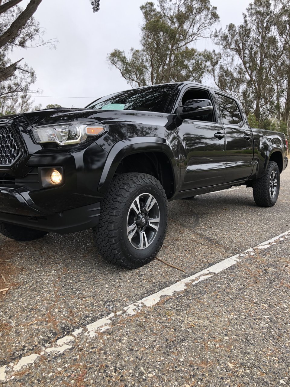

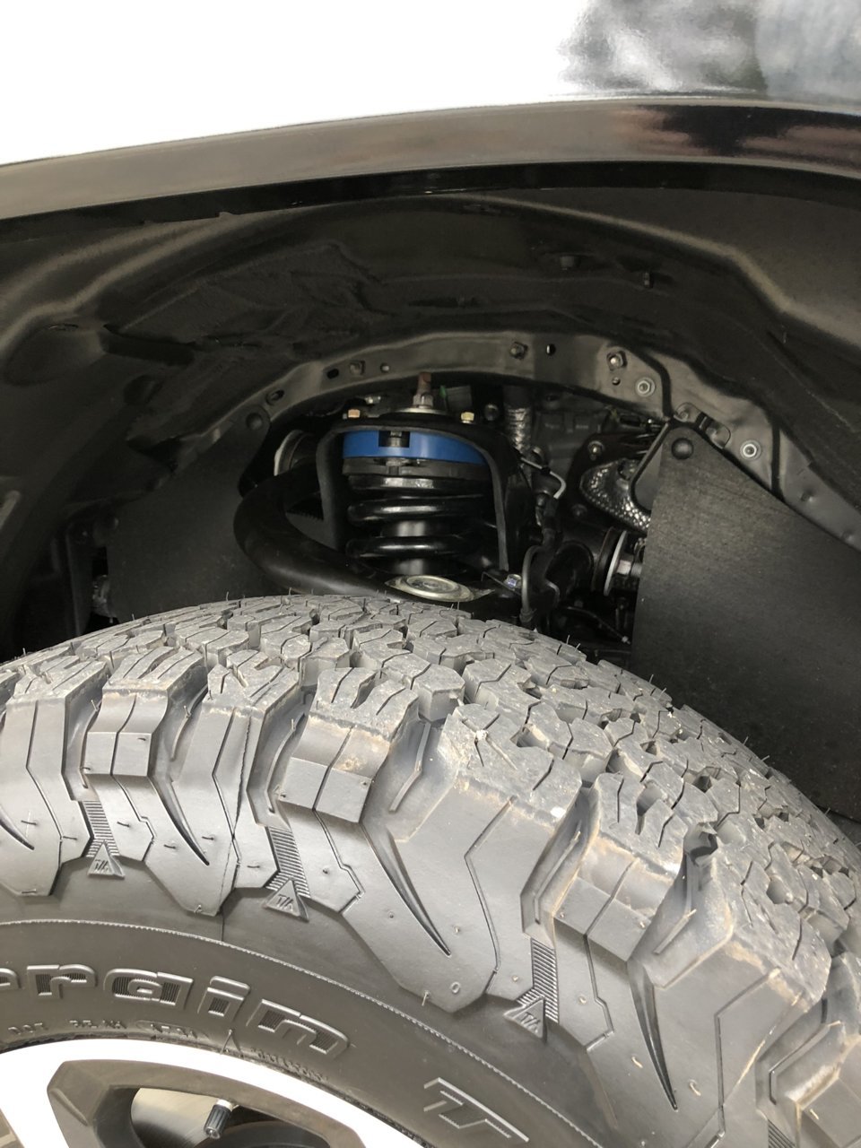

    Got it done today 2 inch spacer front only 265/70 r17 BFG ko2s
    For you number guys!
    Before Driver side 21 passenger side 21
    After Driver side 22 1/2 passenger side 22 1/2
    Level spacer is 1 inch

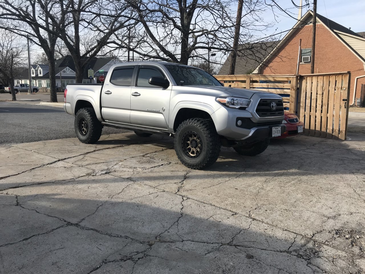

    Stock coils on 4th notch, 1.5” block out back... perfect. Super old photo, but it did look good!

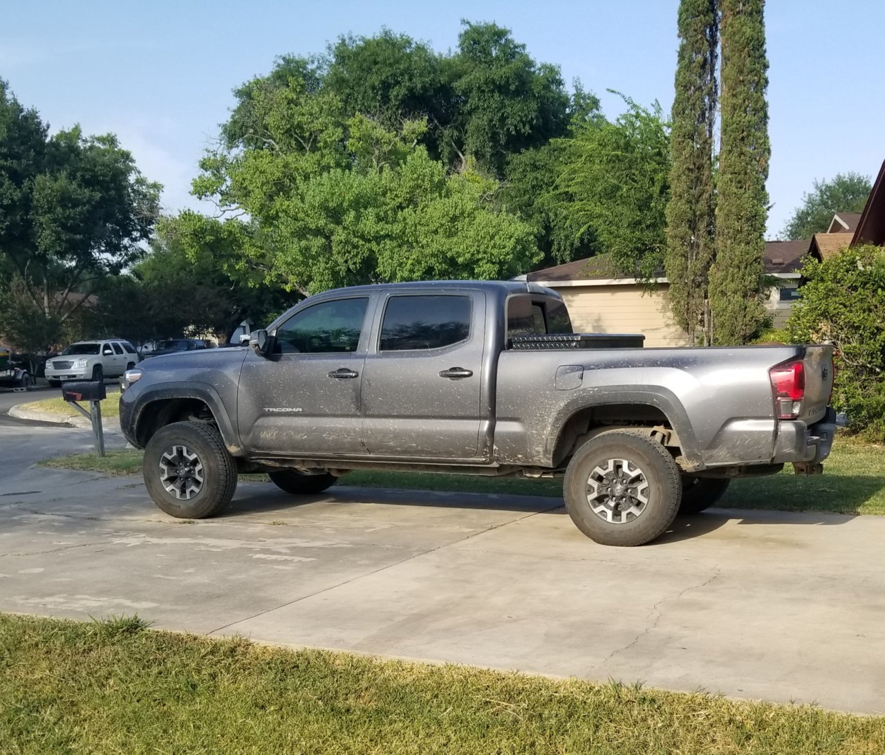

    Puck level
    3 inch spacer up front, aal rear. 2 inch diff drop. Nothing else. Rides like a champ offroad too!!

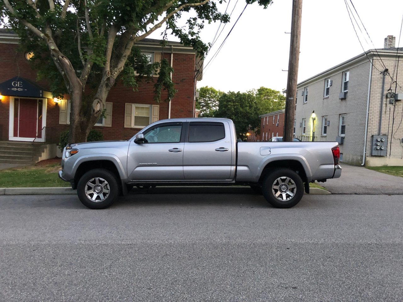

    This is with the 2 inch leveling spacers in the front and 1.5 inch block in the rear. I like these a lot. On-road ride quality feels the same. Haven't try offroading yet. I'm going to put some 275/70/17 on before trying anything. Currently I'm on 265/70/17. I might actually just to with pizza cutters too.
