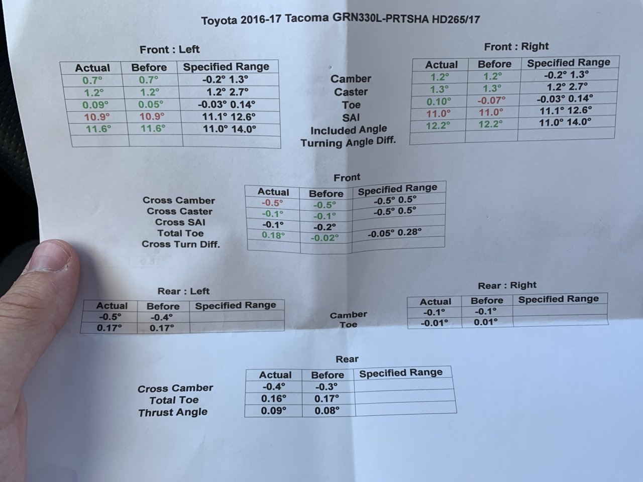

    Alignment specs and steering wheel offset

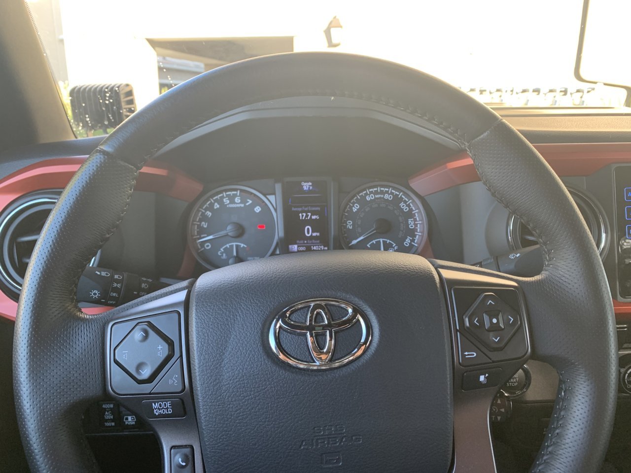

    Ok so just took truck to dealership for 15k service and said screw it and had em check and fix alignment. Here’s the results. Steering wheel is now straight while driving and it still pulls slightly to left like a little bit of drift. I ordered a polyurethane 1/4” spacer from Wheeler’s but have yet to install until after I had dealer look.
    Should I toss the spacer on the left front and have them make sure it’s all good still? Or should I just leave alone?
