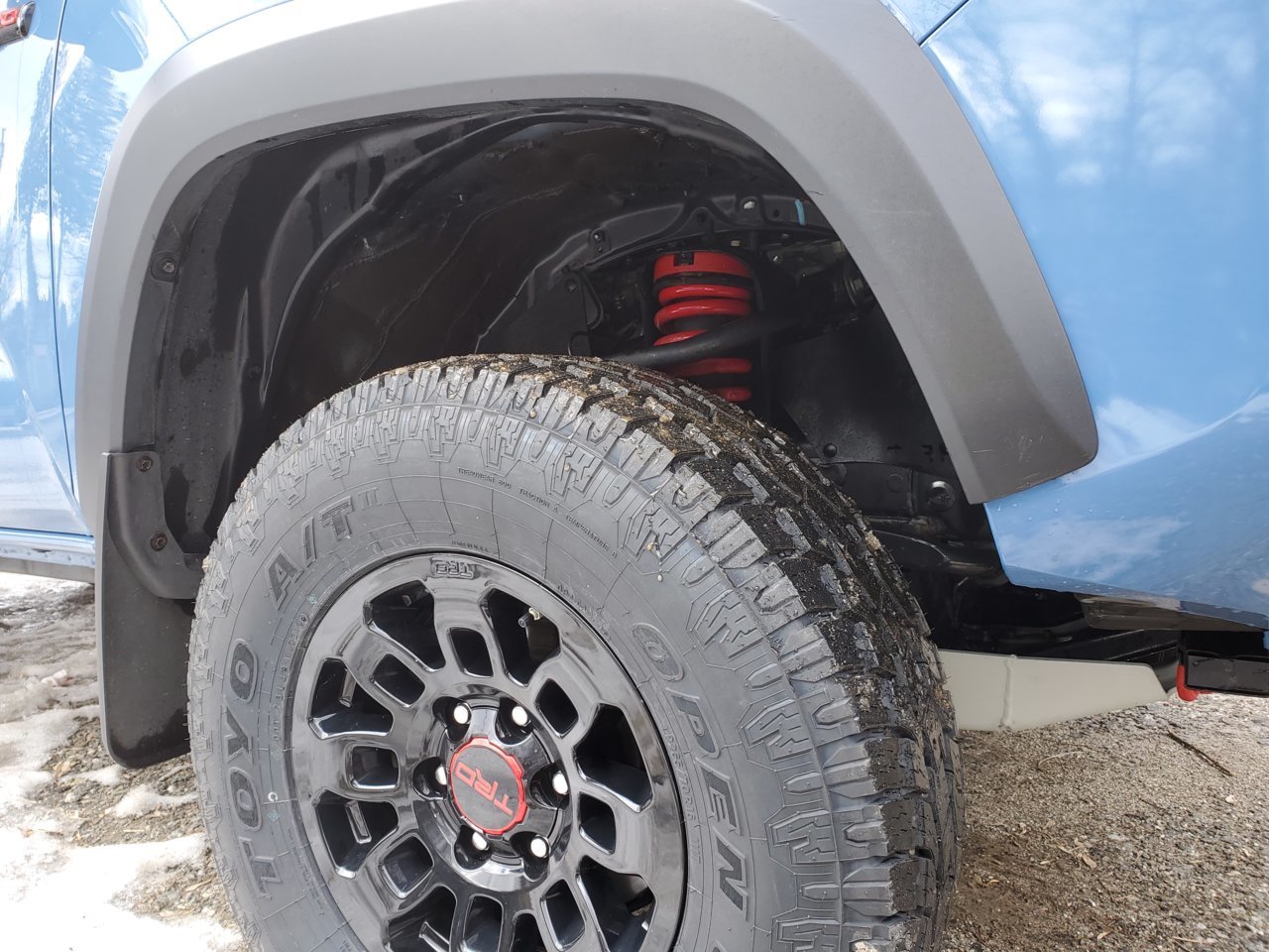

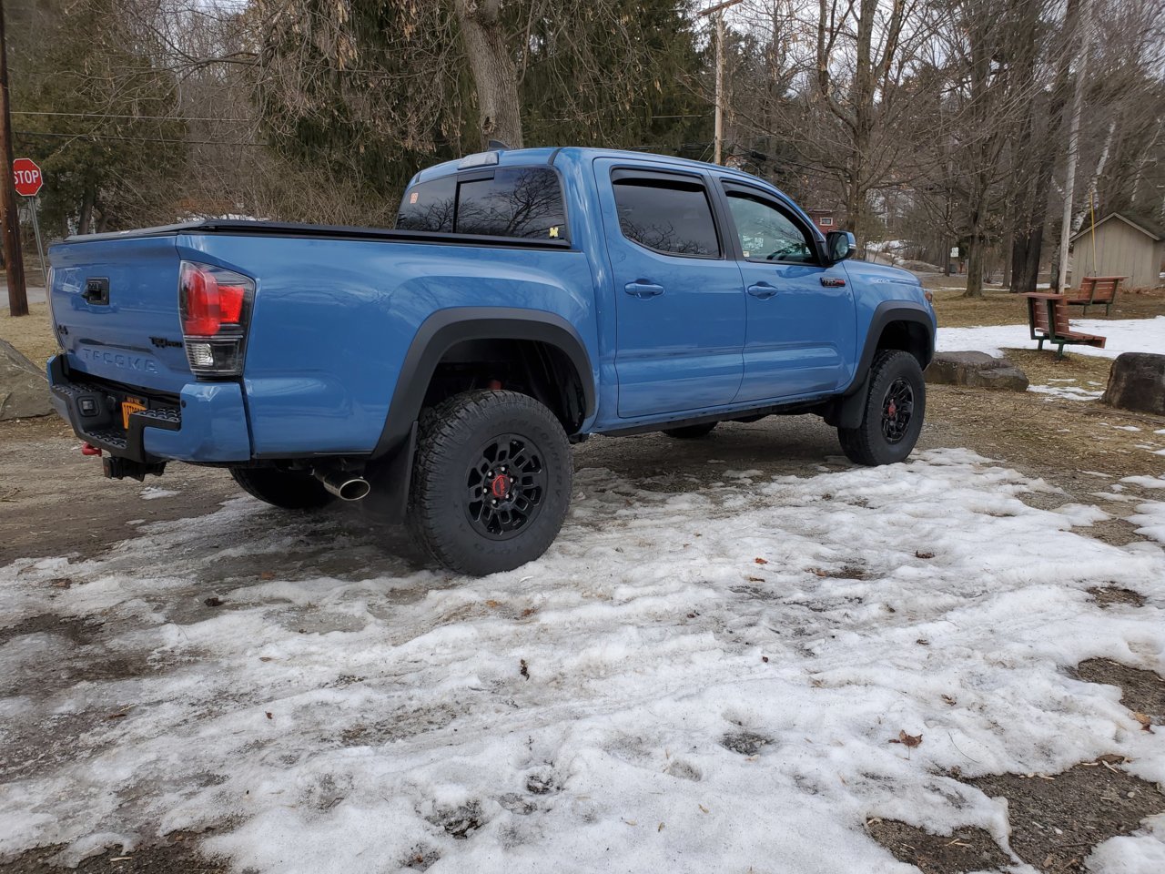

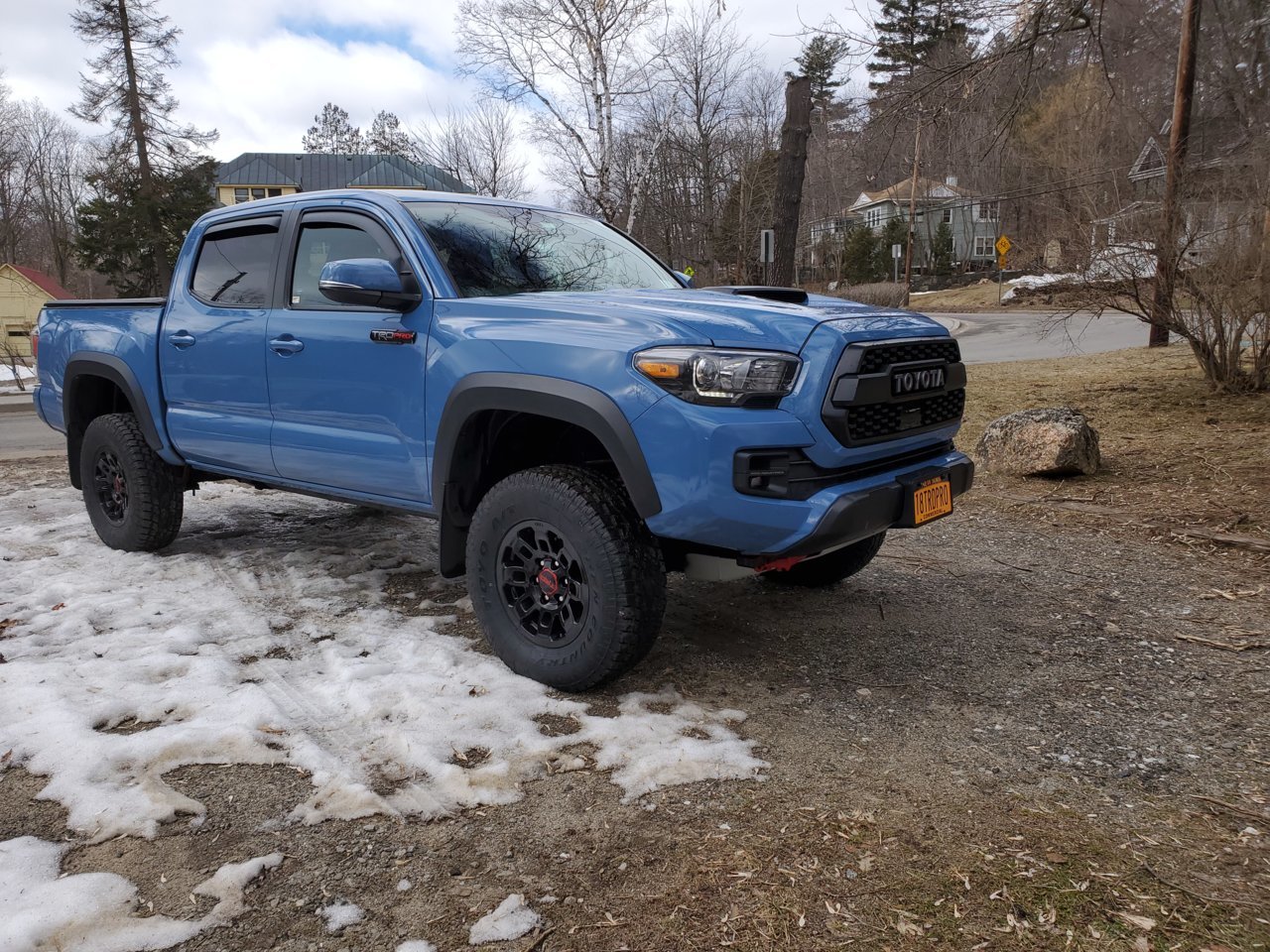

    Well, just finished installing my 2" Supreme Suspension Lift Kit and 265/75R16 Toyo Open Country A/T2's. All went well with the exception of the Diff Drop Kit. The Pro Skid Plate wiil not clear the Plate brackets after install. I need spacers and bolts to adapt the Plate back on. I'm in the process of contacting Extreme Terrain where I purchased the kit. I don't know if I really even need the Diff Drop Kit. The truck seems to sit good and ride normal. I like the look.

    Bilsteins 5100s on the top setting, 4runner Gray TRD Pro Sema wheels, 285/70/17 Toyo AT3s, Sumo Bump stops, TRD exhaust, ECGS Clamshell bushing, 1/4 shim for the lean and one inch rear block, OEM Pro grill and garnish OEM TRD Skid plate, TRD CAI, Demon Brackets, Rigid Industries Pro fog lights, OEM Trail Rails sidebars, Diode Dynamics LED SL1 high and low beam lights, OEM Roof racks, Clazzio leather heated seats, Remote Start, TRD Pro shift knob, tinted windows, Rockford Fosgate 4 channel amp for the headunit and sub and amp combo, OEM Puddle lights, OEM tailgate lock, OEM bed mat, LED interior lights, OEM blackout kit for letters, JLT catch can, upgraded 27F toyota True Start battery, Vleds led tail light kit with Pro tail lights, OEM Rave4 side mirrors with convex spotters,just to name a few mods.
    My Pro skid plate went back on with a front diff drop.

    Nice! I like those red coils.

    Looks very nice! Slight lift and nice tires really helps make these trucks.

    Looks great! I am thinking about putting this same lift on my truck. Did you have to cut off the top of the strut studs so that they didnt stick up above the spacer?

    That's actually part of the OEM PRO Fox Shock Package. Thx.

    Looks like you could have fit 285s no problem.

    yeah, could have, but wasn't sure how big I could go. Plus Tacoma wheels are only 16". Wish they were 17" or !8".

    nothing wrong with 285s on 16" wheels. imo they look better!

    I have 315s on 16 inch
    does not seem like an issue look fine

    The spacers are resest were the strut studs line up. The new mounting points on top of the spacer are off set for the new mounting bolts. Bolt in the top mount first and than use a long pry bar through the bottom of the shock to twist the shock back into alignment with the bottom mount. It will make sense when you go to mount it. A lot of YouTube help out there.

    No cutting

    Theres a lot of people running 285 75 16s on those wheels. Might be doing it myself in a few months.
