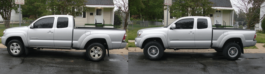

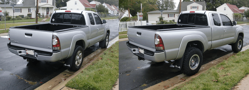

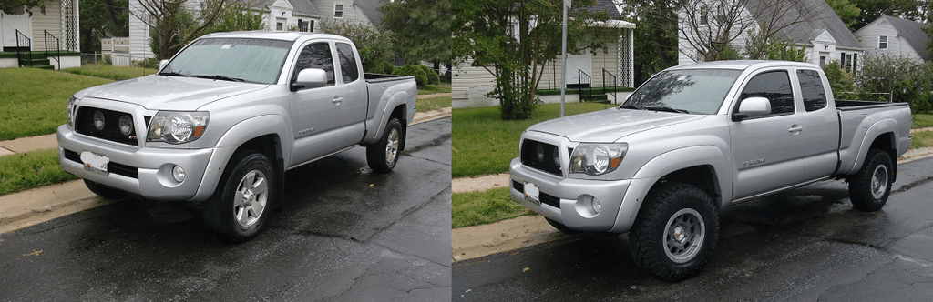

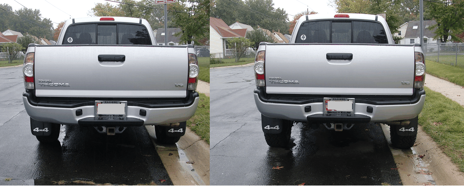

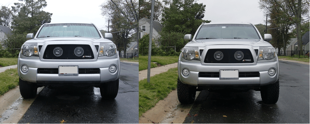

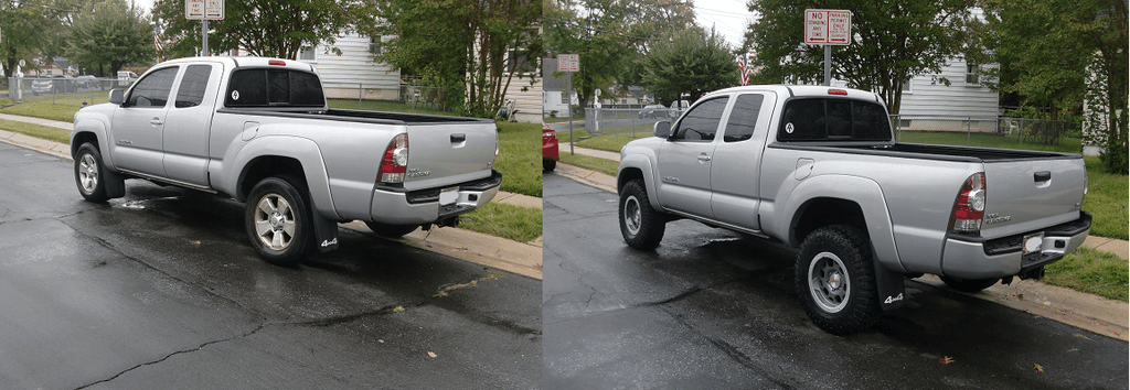

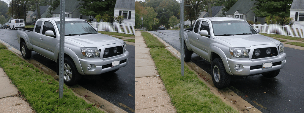

    In researching my new tires and lift, I looked at a lot of before and after pictures. I finished the project this weekend and thought my pics might be useful to someone else. It's definitely not just that I want show off my sweet truck.
    Truck is a 2011 TRD Sport Access cab.
    Before:
    TRD Sport Bilsteins
    17" alloy wheels
    265/65/R17 Bridgestone Duelers
    After:
    Icon Stage 1 front coilovers and rear shocks
    Light Racing UCAs
    Wheeler's three-leaf add-a-leaf pack
    16" TRD beadlock-style wheels
    265/75/R16 Goodyear Duratracs
    I was going for 2" of lift front and rear. I prefer the factory rake to leveled. My truck came stock with just two leaves and the overload. I installed the Wheeler's pack between my factory leaves and the overload.
    I measured before and after from center of the hub vertically to the edge of the fender. I drove around probably ten miles and up and over some parking lot islands, then let it sit overnight before doing the after measurements
    Before:
    Front: 20" and 20 1/4"
    Rear: 22 1/4"
    After:
    Front: 22"
    Rear: 24 1/4"
    I did all the work myself and recommend it if you're handy. I work slow and it took two days: eight hours for the rear and 12 for the front, which included a couple trips to the store each day. In both cases, probably two-thirds of the time was spent on the first side figuring things out.
    Anyway, on to the pictures...

    Looks great! :thumbsup:
    Love the wheel and tire combo you chose! :D

    Thanks, I'm really happy how it all came out. I got the wheels new in black, but had them powdercoated gunmetal. For some reason, I like the black wheels on every color truck except silver.

    excellent... exactly how much lift I want one day

    Super simple. Super effective

    any vibrations?

    I haven't driven it a ton yet (getting an alignment tomorrow), but feels great so far. The Duratracs have a bit of a hum at speed on the road, but no vibration.

    Like the look a lot. Did you end up with 16" or 17" wheels/tires?

    16" wheels and tires. I corrected the original post.
