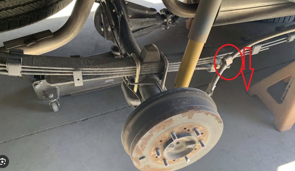

    I added 2" lift blocks on my 2019 Tacoma SR5. Now my parking brake has a much shorter pull height. It still works holding my truck when parked, but I hope this is okay.

    Screenshot 2024-02-18 185748.png Bend down the brackets that have the brake cable and bolt to the leaf spring.
