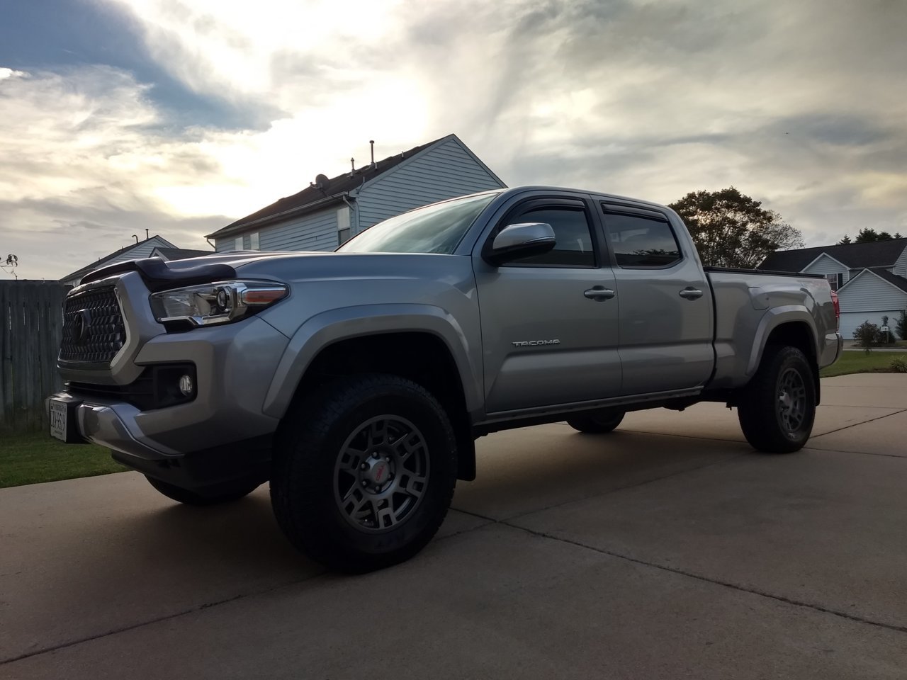

    I did some 265/70/17 SL toyo open country at2 on the pro wheels. Great stance with my little bit of lift, speedo is dead accurate and no extra added weight from the new tires and wheels versus my factory set. Rides and drives great and no decrease in gas mileage.IMG_20181009_181855269_HDR.jpg IMG_20181009_175623886_HDR.jpg

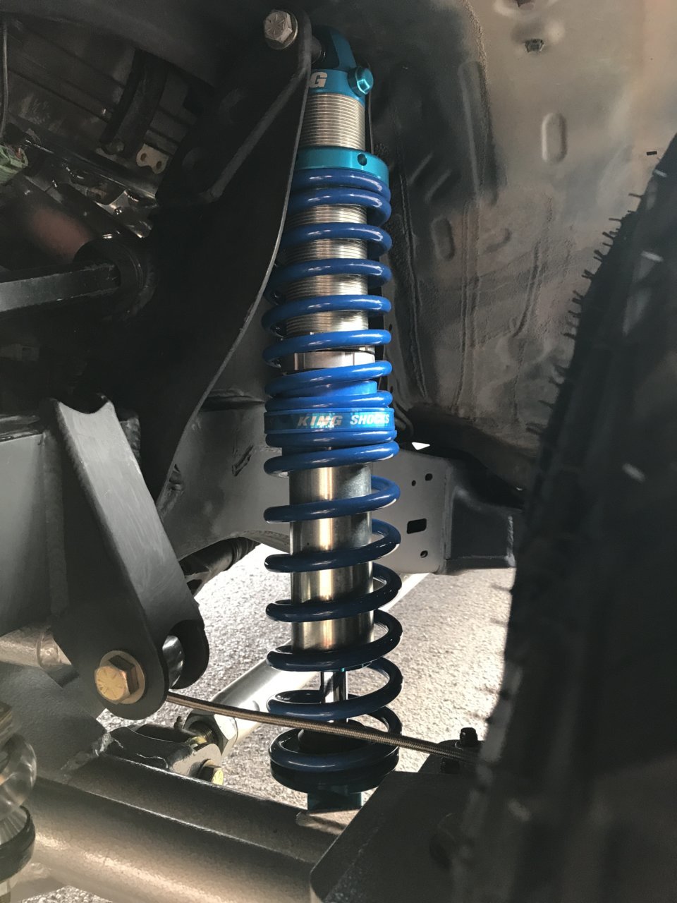

    Let me ask you this then. If when you crank the coils, if all you are doing is compressing the spring, how does the truck get higher? :rofl:It gets higher cause the spring pushes the truck back up ;)
    I think you don't understand the concept of spring rate. What you are saying is only true if your ride height is at full shock extension.
    Like I said before, if it were possible to crank your coils at ride height with the truck on the ground, you would see in real time that your springs do not compress more, it just lifts the truck higher. And it will just keep lifting the truck higher and higher until you max out your shock extension. THEN it will compress the coils more.

    Let me explain. And yes I do understand what spring rates/constants are preload mean. Most shock/spring assemblies have around 1 inch of preload. That is one inch regardless of weather the truck is on the ground or jacked up with wheels in the air and shocks topped out. The spring is pre-loaded 1 inch at all times. If your spring rate is 590lbf and you have 1 inch of preload you need to apply 590 lbs of weight before there is any compression of the coil. When you jack up a coilover, the total max length or stroke of the shock doesn't change obviously, all that happens is you are compressing the coil further, adding additional pre-load. For example if you crank up your coilover by 1 inch you now have one inch of additional preload. This is what gives the truck lift. If you had one inch of preload to begin with and crank up your coilovers by another inch you now have 2 inches of preload; if you were using these hypothetical 590lbf coils, you now need to apply 1180 lbs of weight before there is any compression of the coil. Because the vehicle weight has not changed, you get a lift.
    Consider this: if you get an OME lift for a 3rd gen double cab Tacoma you can choose either 887 coils or 888's. Both have the same spring rate of 590lbf/in. 887 has a free length of 400mm, 888 has a free length of 405mm. So the 888's are only 0.2 inches longer but give 0.5 inches more lift. That is because they have 0.2 inches more preload than the 887s. The shock/coil assembly is the same length for both scenarios assuming you are using the same struts.

    @swissrallyman yes that's true, i understand that you have to preload them more when the shock is off the truck, but like i said when the truck is on its own weight, the length of compressed spring will still be the same. The reason 888s give more lift than 887s is like you said, they are longer. Only slightly, but because of the geometry of the IFS, it will double the amount since the coilover is mounted about halfway on the lower control arm. Same reason a 1" spacer will give 2" of lift.
    I play with my ride height a lot, and no matter where I set it, the length of the compressed spring with the truck on its own weight stays the same. Like I said, if you could adjust the coilovers with the truck on the ground, you would see that you are simply raising the ride height, not compressing the spring more.
