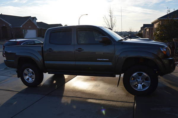

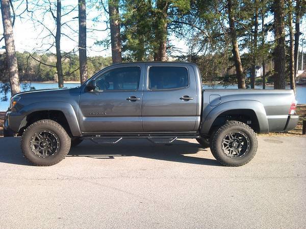

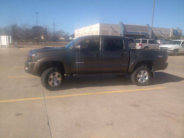

    I have the Ironman4x4 lift with an AAL in the rear. I got 2.5" initial lift, but it has settled to 2". I'm also within spec on alignment without UCAs.
    Not the best pic, but...
    The above pic is on an incline, so it makes it hard to see. However, it is with the lift and 265/70/17 tires.
    Here is one after the lift, but still on factory Dunlops.
    Here is a pic I took with my phone the day after putting on the lift. Still with the factory tires, but it looks like it has the "bro lean" in this pic. That has since gone away.
    I need to get some better pictures.

    Looks great. exactly what I want. I had the same tire on order( 265 70 17) but decided to go with 275 70 17 instead,just slightly taller. I will have the same lift, just using 5100's and a 1.5" aal in the rear . I''m going to set the 5100's at 2.5 front and expect it will settle to 2" as did yours.
    When you say you are on spec for alignment with out UCA's could you please explain what this means? I understand the alignment part don't know what is the UCA. Ahhh, never mind,now I get it, UCA is upper control arm. Some kits come with diff drop hardware and I'm nervous that I could have drive-line or alignment issues , something I was really trying to avoid. I figured a minimal lift plus tire increase would avoid the complexity of the higher lifts mechanically and retain the factory dependability. My truck will be a daily driver 98% of the time going to and from job sites , I do not carry loads very often. I just want a moderate lift with minimal amount of change. I need dependability and safety more than an off-road rock crawler truck.
