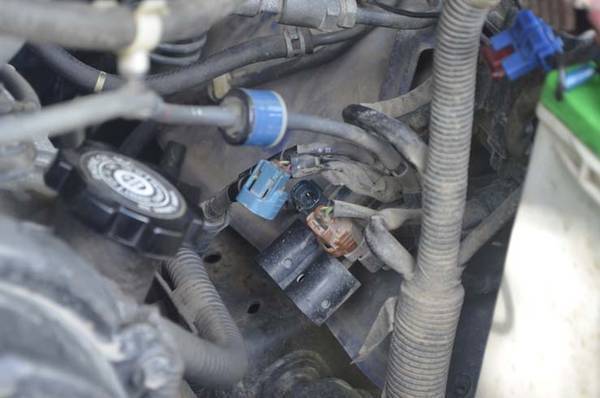

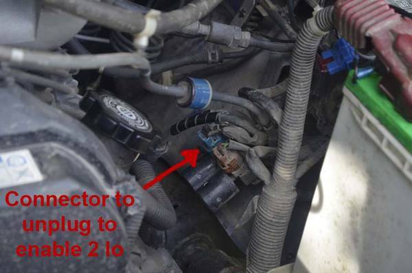

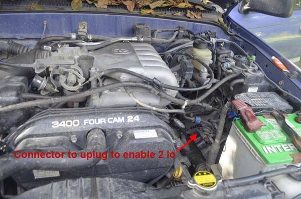

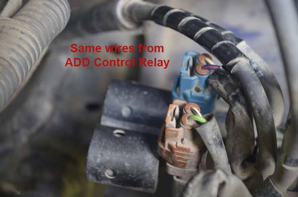

    I found a very simple way to get into 2 lo without any mods, wire splicing, or even removing any interior trim pieces. Simply unplug the connector under the hood that operates the VSV on the front diff. This does the same thing as installing a switch on one of the wires (prevents the VSV controlling the ADD from operating). I'm not sure which years/configuration this will work on but, any truck with a VSV controlled ADD will work. It should work with most J-shift transfer cases. The electric operated ADDs should work too if there is a connector that is easily accessible.
    This method of accessing 2 lo is good for anyone who wants to keep their truck stock, but occasionally could use 2 lo. I will be using it for occasional trailer backing. The downside is, you have to get out of the truck to enable 2 lo. This however acts as a fail-safe so that you don't accidentally reengage the add while your truck is moving.
    http://youtu.be/Rd80in64HUM[​IMG]
    [​IMG] [​IMG]

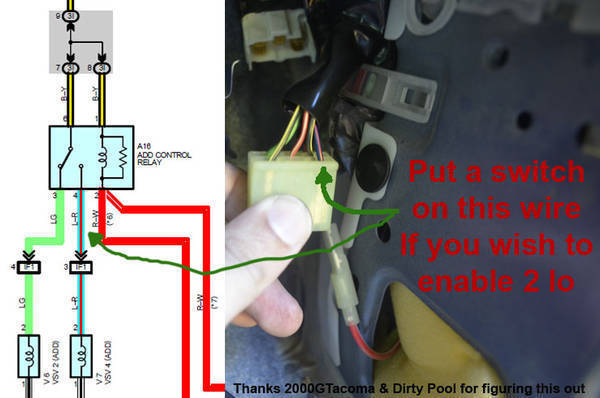

    And if you Want to install a switch instead, this is the wire that 2000GTacoma found with Dirty Pool's help.
    [​IMG] [​IMG]
