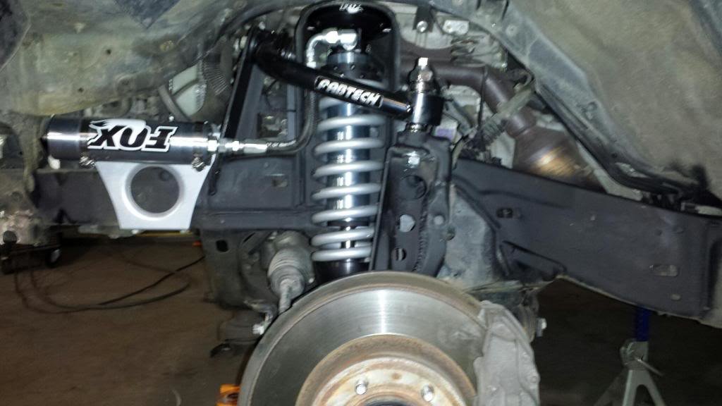

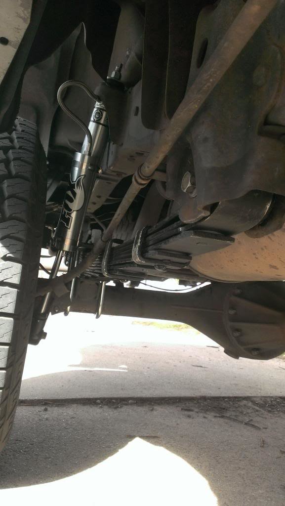

    I finally pulled the plug on MT a few weeks ago since im still at 46k.
    Went with All-pro leaf pack, 10"x 2.0 Fox RR shock that DSMS built for me.
    In the front: Fabtech UCA, with 6"x 2.5 Fox RR coilover
    Also did some gussetting( TC kits): spindles , cam tabs , coilover buckets
    Note: the original revtek spacer lift that came on my truck had a 2" spring preload spacer AND a 1/4" spacer that went on top the whole shock.
    I threw this 1/4" spacer in to help get a little lift without preloading the spring as much in matching to the almost 3" lift in the rear. Comments?
    Il be measuring for air bumps and straps on all four, but so far around town truck seems stiff and im trying to stay hopefull.
    Cant wait to do some tuning and get off road to see what it feels like.
    At 100k il prolly be ready for LT. But if your like me your always thinking about it. But glad il had more time to plan/decide because iv gone between so different options and changed my mind ect...
    I was pretty set on the defined SUA kit wen i LT, but the pics of their shackles dont look all that different. i like the 9" or 12" other kits are using. are these new rear hangers?
    And now im leaning toward a +2" front kit so i can match the rear with a 2" wheel spacer...still cant get over mismatched track width..
