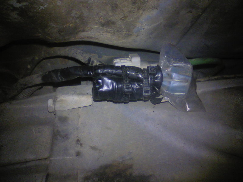

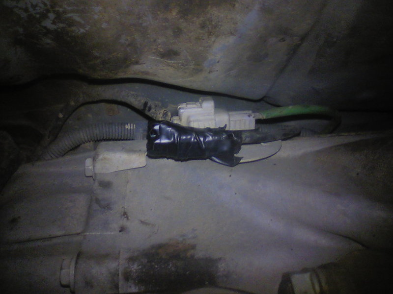

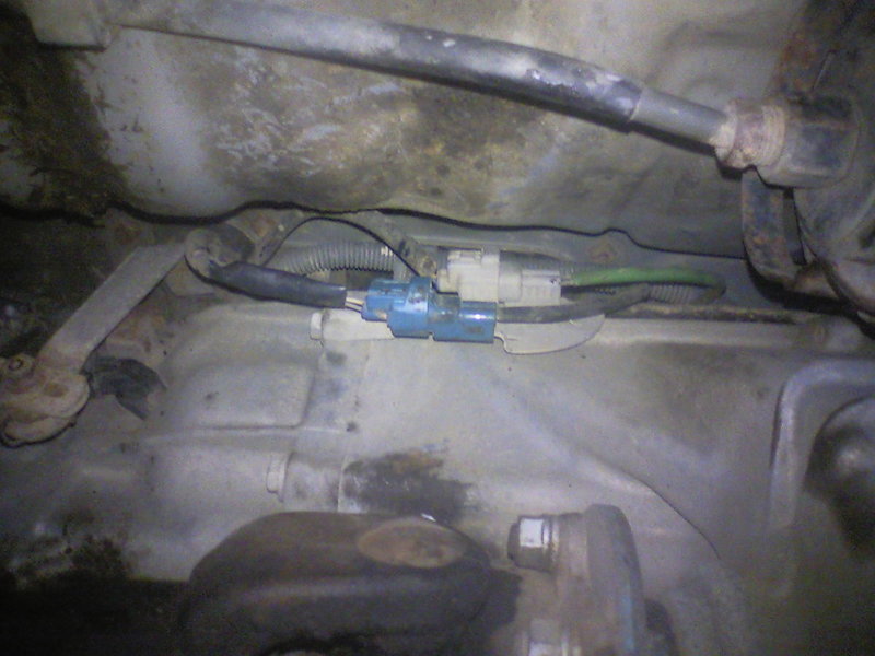

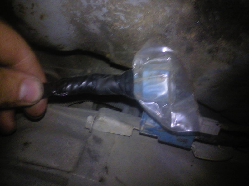

    so i just did the 2 low mod after finding a link but was unable to find any pics so i thought id make a thread with pics...
    heres how its done...
    you unplug it and seal the ends.
    and zip tie it in place and your done!

    i did this as i have a very long very steep blacktop driveway and sometimes have to haul a heavy trailer up it and was afraid of useing 4 lo on the asphalt with a full lock turn at the top. this made it much easier both on me and the truck.

    i also need to mention that 4 lo is still usable you just push the button and shove it in. also you can push the button in 2lo to go from 2 lo to 4 lo and vise-versa without putting the truck in nuteral...just let off the throttle and push the button.
    this push button feature is very handy; for example your on a tight trail in 4 lo and need to turn sharper than 4 lo will let you...push the button out and your in 2lo -done turning? -push it again and your in 4 lo.
    4hi and 2 hi operation remain unchanged and fully functional.

    it took me less than 5 min from the time i crawled under the truck till i was ready to try it out. easiest mod ive ever done!
    all your doing is removeing the feed loop that tells the ADD(auto differential disconect) to engage when lo range is selected.
    essentualy the same as leaveing manual locking hubs unlocked in the front.

    first gen trucks with the button shifter that has a button that controls 4wd in high range and is pushed forward for 4lo- this mod allows you to select 4lo wothout engageing the ADD makeing for 2wd lo with on demand 4wd lo by pushing the button like you would for 4wd in high range
