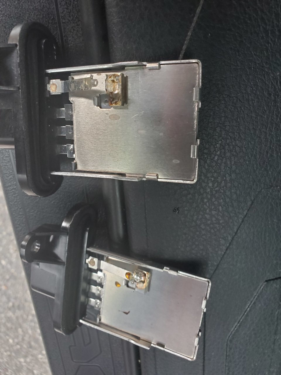

    OV tune Wet Okole seat covers
    Picture of second resistor on left. Seemed like it melted more than the first. Looks like it definitely is a failsafe of some sort.
    BigWhiteTRD likes this.

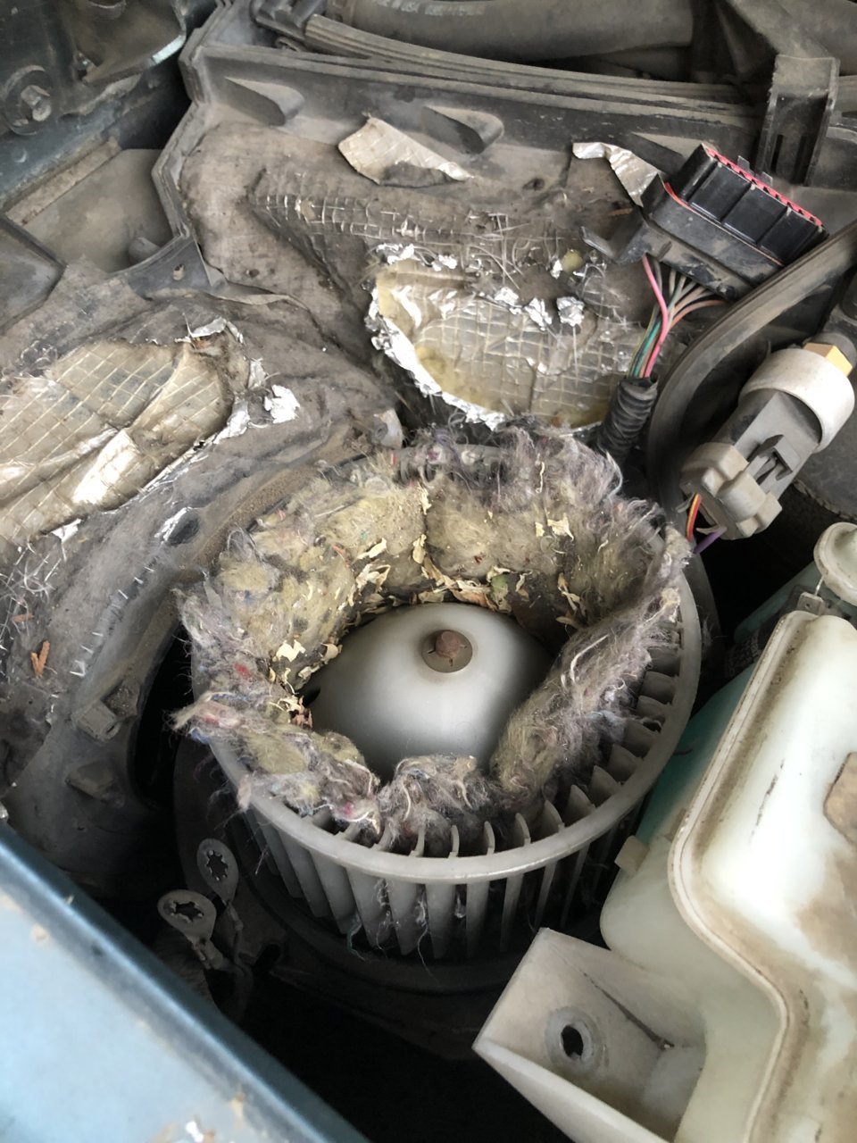

    So, my sister’s 90s explorer wouldn’t blow strongly for a year or two before i visited and checked it out— seems a rodent had made a nest in the HVAC case out of the firewall insulation. It completely encased the blower motor, and blocked airflow over the evaporator core as well. I don’t think a clogged cabin air filter is gonna hurt it :)
    JohnnyTaco[OP] and Canufixit like this.

    I can smell this picture.

    447
    exactly what I though as I had that same smell long ago, somehow it got into the air blow/vent
