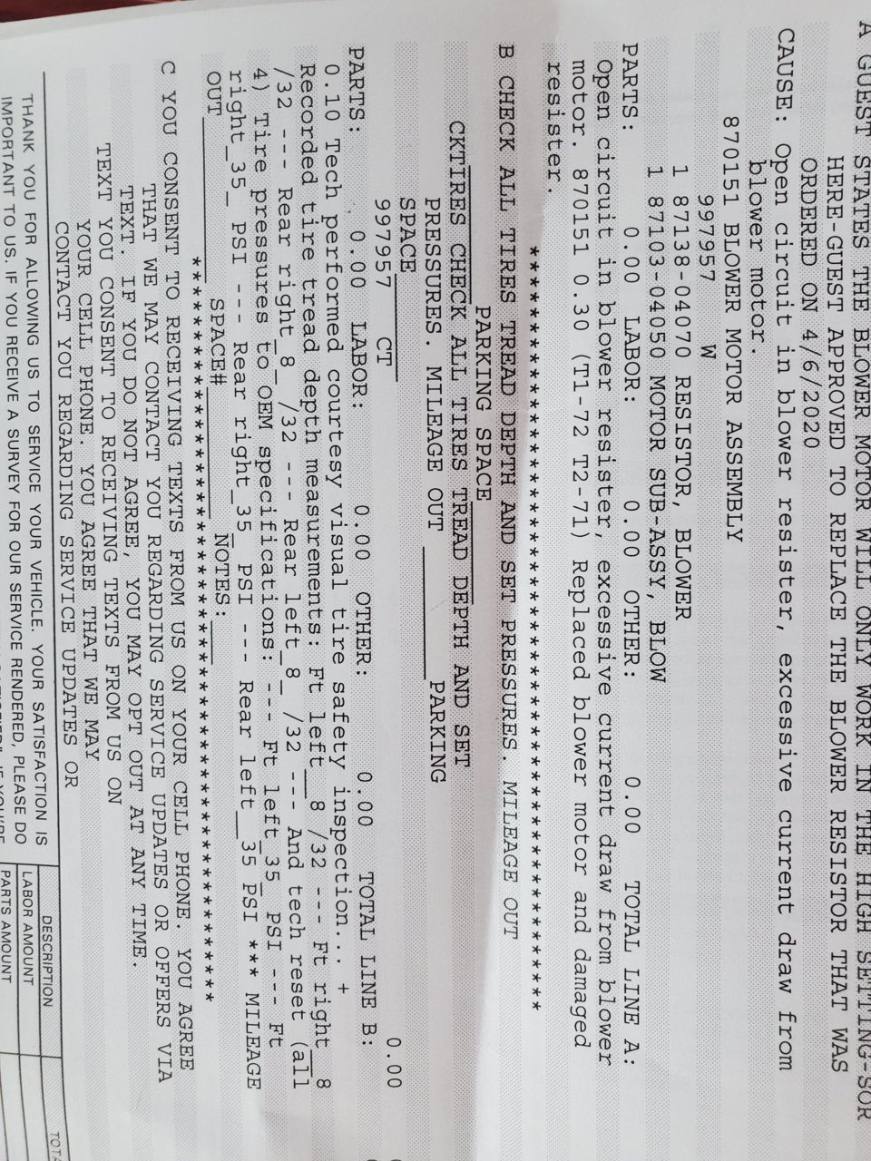

    Update. So came to the dealership today and they switched out my blower motor and resistor. Here's what they said...

    Car is running fine again for now and hopefully it stays that way. Just a quick little thank you to everyone who posted and offered advice. Much appreciated. Stay safe. Stay healthy. Wash your hands and don't go outside unless necessary.

    I see the tech set the tire pressure to 35 psi, is that correct for a sport? My OR is 31.

    Look at the sticker in your door jamb

    Np. Thanks for tuning in. :)

    Haha first thing I did ;)
