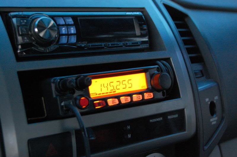

    Thanks for all of the positive input, my FT 1900R just arrived - going to install it tomorrow.
    Monkey - How'd you install your Yaesu in the single DIN slot? Looks like the radio is a little too deep to fit in without some serious trimming.

    Oh yeah..it took some trimming of the dashboard with a demmel but that was mostly for the added switches I installed onto the face of the double din mount..I think there would be no trimming needed if if weren't for the switches. I used a double din and stacked the radios on top of each other. If you go this route I would suggest in using the Metra double din kit as opposed to using the scosche kit like I did. The metra kit will allow you to use the stock OEM metal brackets, you can't with the scosche kit.

    I like the thought of using the stock brackets - I've got the Schose double DIN at the moment, maybe take look at that and see what I can make fit..
    I know heat is a concern of a lot of people with mounting these in DIN slots, personally I don't see it.
    I like the idea of mounting in the recess ahead of the shifter; although - I'm someone who likes to push buttons. It's not something easily done when it's in that location..

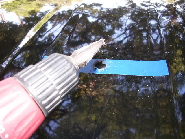

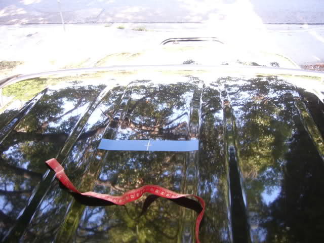

    Lots of measuring. Lots of drilling.
    The wiring and attaching the PL-259 took all of about 20 mins..

    Excellent install! The NMO-style mounts are pretty great little pieces of hardware. I did ream the hole before threading the base in - but, I did't scrape paint away to get better conductivity for a ground.. Think I'll be alright?
