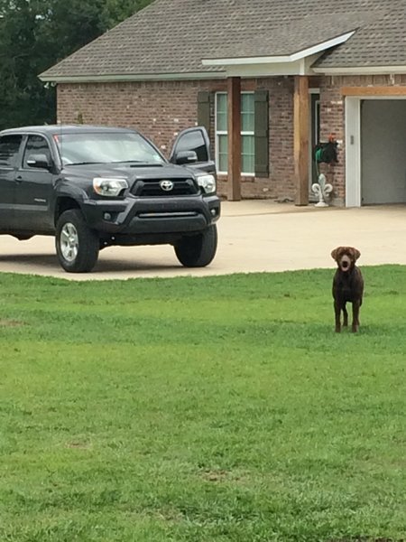

    •3” front blocks •2” steel rear blocks •1.25" spidertrax spacers for clearance •285/70/17 (33's) Ko2's •20% tint
    Ok so im putting blocks in the back (dont try to persuade me not to) and i cant decide between 1.5 or 2 inch. I have a 3 inch lift in the front. Pics would help if you have one of these! Thanks in advance.
