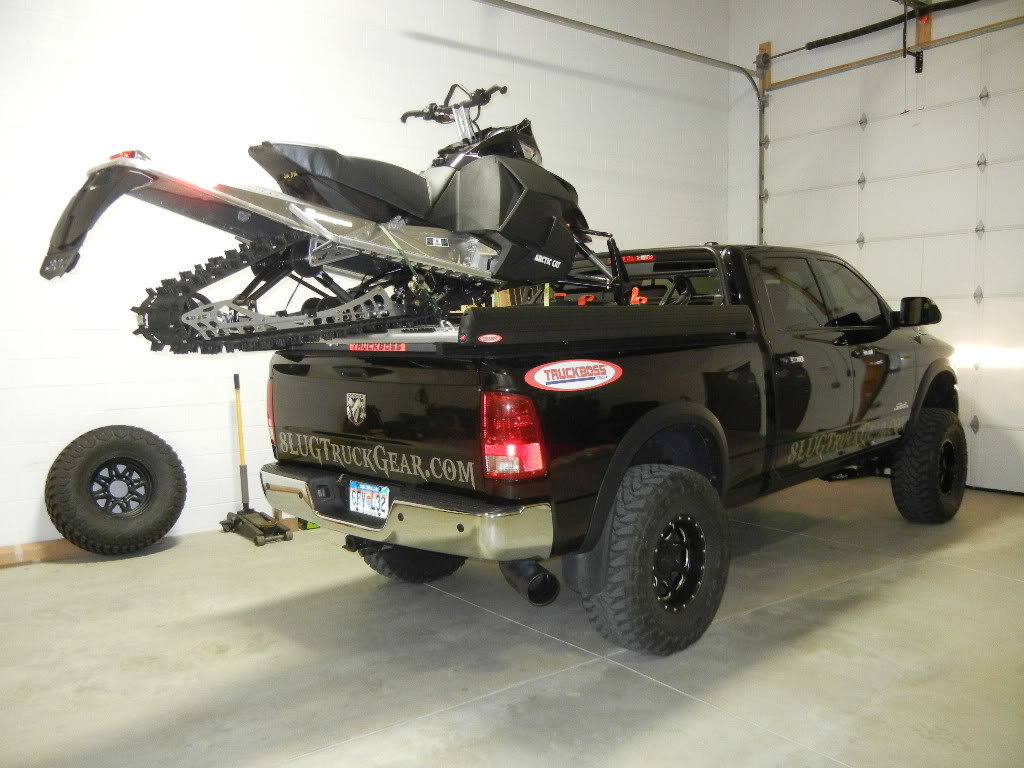

    I'm too lazy to save the photo and paste it so here is the link
    http://www.tacomaworld.com/forum/at...7d1300899615-home-made-sled-deck-imag0050.jpg
    That is on a six foot bed and only looks to be a 154. Imagine two sleds, up higher, and the same length or longer. I thought about building a deck for a single sled for my long bed but my sled is over 11 feet long. As cool as it would be to have one, it would look ridiculous and with two sleds you will probably be pulling wheelies when you accelerate.

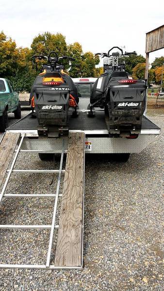

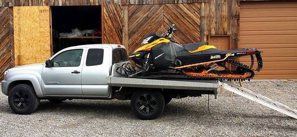

    I realize this is a way late on this thread but this is one of the only places I found people talking about 2 place sled decks for Gen 2 Tacomas. I wanted what tfeltz73 a way to carry 2 sleds on my tacoma without a trailer because I live in an area where I can't keep a trailer and I'm unwilling to buy a bigger truck that gets terrible gas mileage. So instead of building a sled deck I built an easily removable flat bed for my Tacoma. The conversion to put everything back to normal is less than 2 hours. So I'll drive this through the winter and put my normal bed back on in the summer. I've tested it out on the canyon and it handles corners bumps just fine. No swaying, No tipping. The only thing that is a must is you HAVE TO have airbags installed. Running high psi in the bags keep the deck from swaying in the corners, keeping the center of gravity where it should be.

    wow thats a nice looking deck. might have to look into that myself. i hate towing a trailer when ive got my sleds with me. ive got the garage space for them so dont need the covered trailer as was suggested above.

    A ready to ride sled is around 525 lbs, that's not counting accessories and snow/ice. I don't see how you can have 2 sleds + Deck + Ramp + full fuel in truck + 2 guys + gear coming in anywhere near the max allowed weight in a Taco. You are probably carrying twice that. I feel I'm pushing my Taco with one sled on a deck!

    I went and weighed it today. 2 passengers, full tank of gas in the truck and sleds, all our gear, ready to go snowmobiling, 5520lbs. So slightly over the GVWR but not much.

    UtahYota, that is a great system!
    By my estimation you are only 20# overweight, not a big deal and definitely not something that would shorten the life of the truck.
    Can you provide more details about the build?
