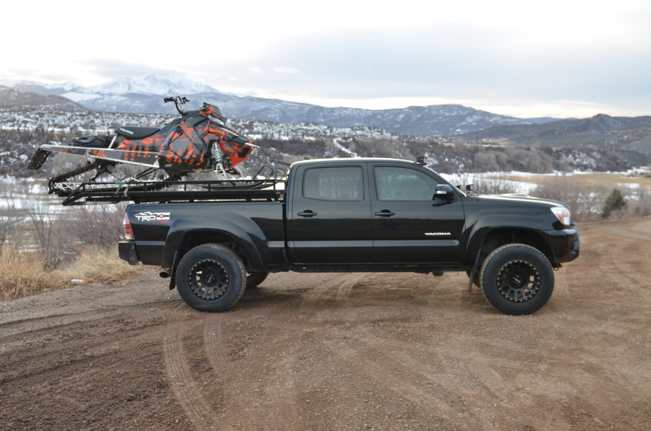

    As an update. I drove this all winter last year. And with the terrible snow season we had last year in utah, we spent a lot of time chasing storms in Wyoming, Montana and Idaho. I drove the flatbed in every condition you can imagine, and it performed perfectly. Through tight canyons, on the interstate at freeway speeds, and ice packed roads. We never had any close calls or problems with the Tacoma handling the load.
    For those of you wondering about the build. Its completely aluminum, with the exception of the painted wood boards as the floor. We removed the stock bed, lights and bumper, to save weight. The flat bed was significantly lighter than the stock bed. We used the original 6 bolt locations to secure the flatbed to the truck. Now that we have it figured out, we can do a complete switch in an hour and a half. So at the end of the season I just put my stock bed back on.

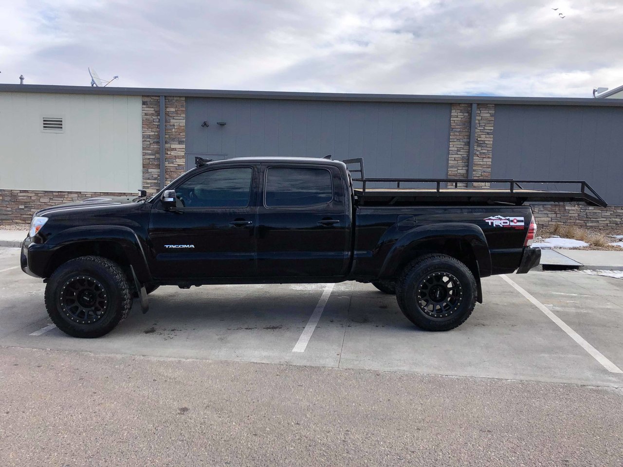

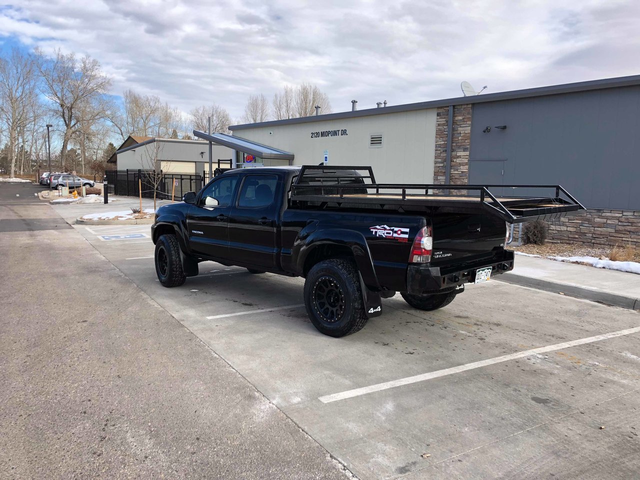

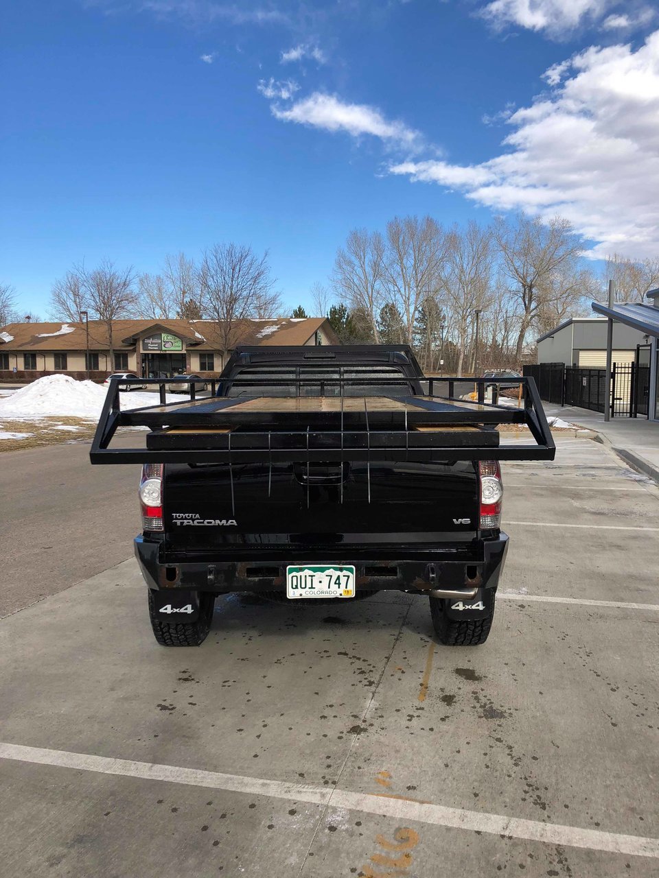

    I know this is late but I just put on my single place deck and am super pleased with it. I added air bags to try and take sag out. Sure beats hauling a trailer. Halls my 155 great!

    Looks awesome man! I’m new to the forum here. But wanted to ask you a little bit about your deck. I have a 16 Toyota Tacoma with the 6 foot box and was wondering how much that deck cost you approximately. And do you have a ramp with it?, and was looking for the specs on the deck I would love to make mine identical to yours!

    Sorry I haven't been on Tacoma world in a while! If you still have an interest in the deck specs let me know! It cost me $1000 with ramp and all!
