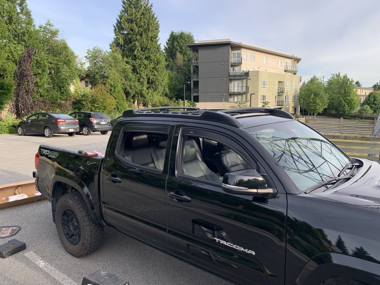

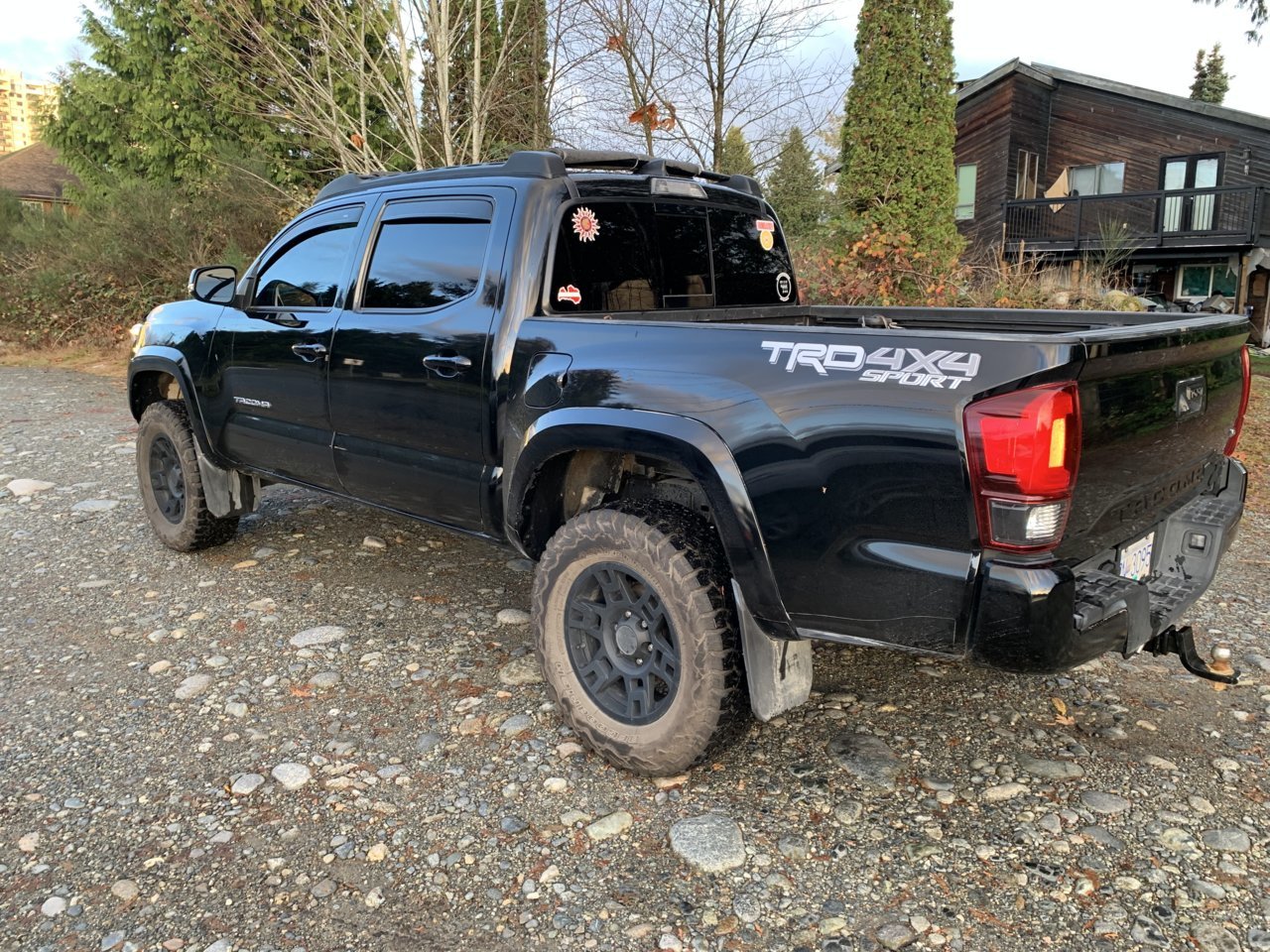

    Haha thanks! it’s the only way to make my truck fit in that stall. Condo living sucks…

    Yeah the sport hitachis are like toothpicks compared to 5100s or OME. Also I had a clunk going over speed bumps, thought it was my body mounts. Now with the new suspension, no clunking at all.
    I actually was very open with my wife about the price, she took it pretty well surprisingly haha. I told her my truck is pretty much paid off so it’s time to do some fun things so we can explore the nature more, she agreed. Now need to get a hard shell RTT and bed rack… It’s never ending.
    I’ll post some more pics when I pick up my truck on Friday after work.

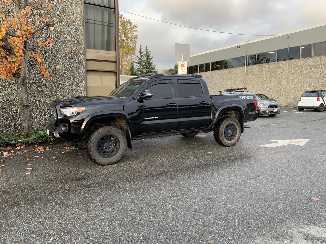

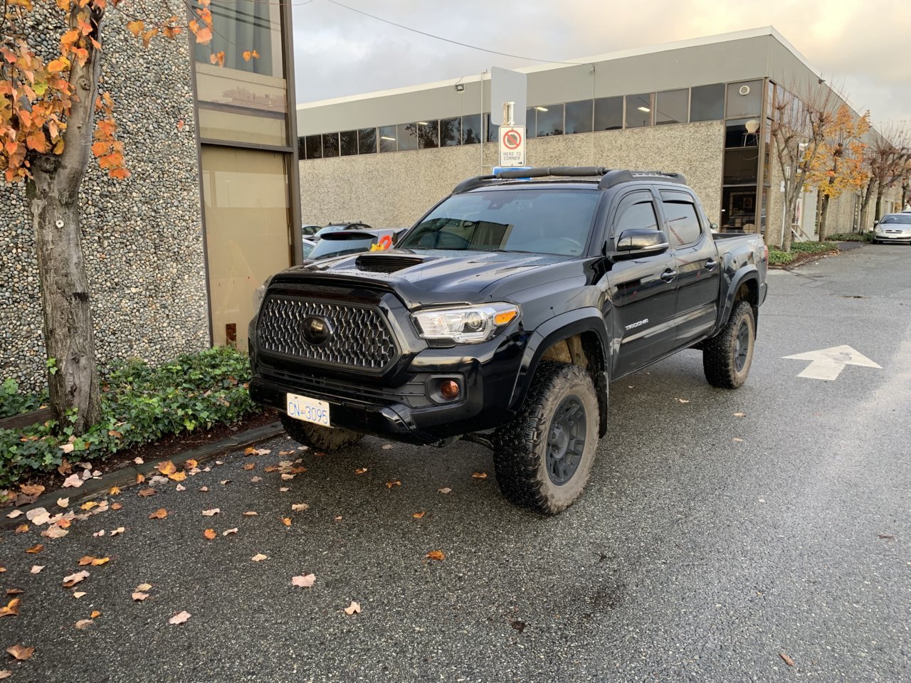

    Found some more.

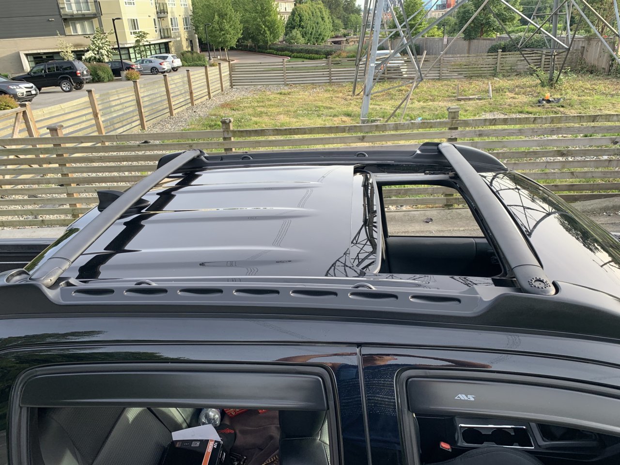

    I didn't realize that OEM roof rack has slide out cross-bars...until I saw a Toyota video about the 2021 Tacoma.
    Very nifty idea...how do you like them?
    And yes, that parking slot is challenging!
    I like that I can see how a lift looks on your truck because I have the same model/color Sport.

    I like the OEM rack. I was thinking of getting prinsu, but I have a sunroof and IMO prinsu looks kind of weird. Also, prinsu is noisier on the highway. The biggest disadvantage of the OEM rack is the load capacity, but it works just fine for me.
    OEM rack matches nicely with the rest of the truck as well.

    The reason I said I have the sunroof and didn’t want prinsu, was because I use my sunroof a lot and would hate to be looking at crossbars.
