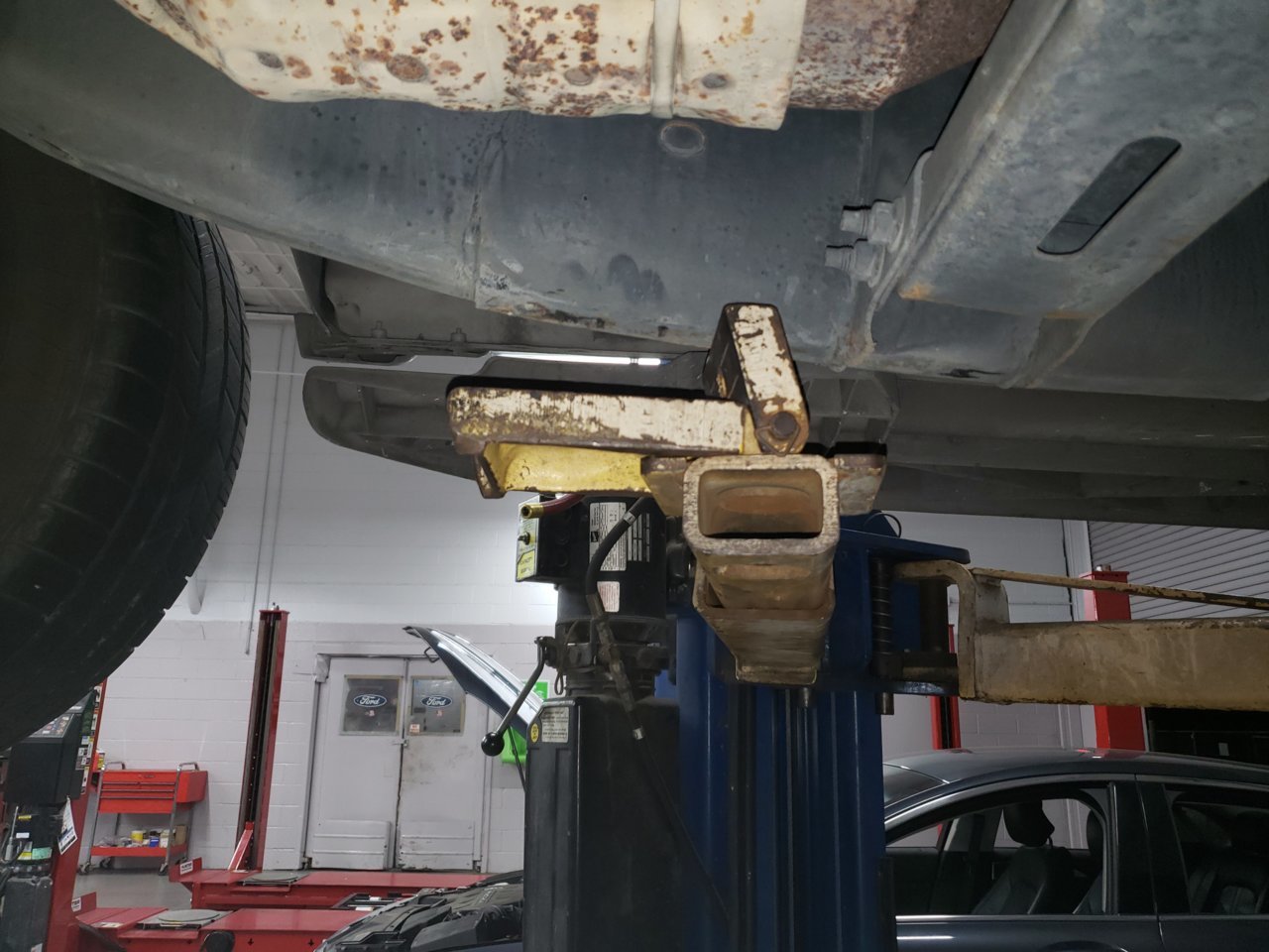

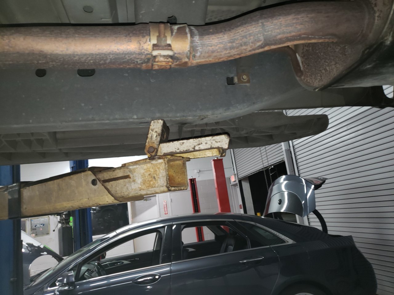

    Here's a picture from work now, it's a F150 but it's still the exact same princeable.
    What @stickyTaco said about lifting it off the ground slightly and shaking it a good bit before going up high, it's a really good point to make. If you can't knock it off by rocking the shit out of the truck its not falling off on its own.
    russperry20[OP] likes this.

    May be a stupid question by why fold the pad up like that? Why not keep the entire pad flat/horizontal for more surface area?

    F150 has engine splash shield brackets in the way in front so it's easier to do with the pads flipped up.
    Also if it's got running boards I would crush them with the arms if the pads were not flipped up.
