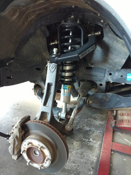

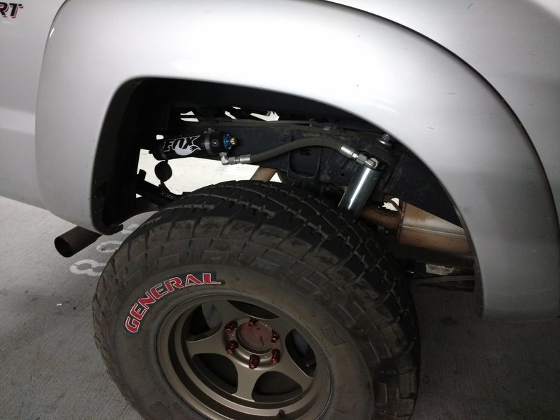

    In the rear I got all pro expo springs and the fox 2.5 DSC they have on their site. In the front I have Maxtrac spindles, 6112, and dirt king ucas

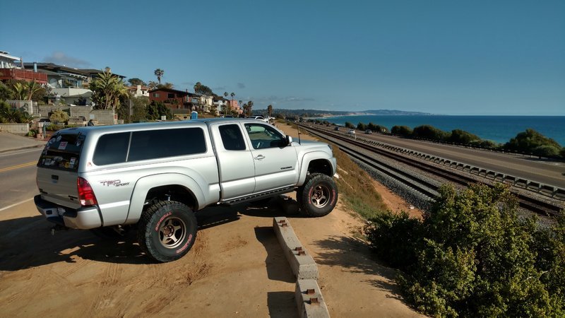

    Truck looks great. I am running the 6112's in the front and 5100's in the rear. Handling is much better over the stock 4600's I think but I was a little unimpressed with how much lift it gave the front. The shop installed them on the 4th notch and there are 5 so i know it can go a little higher but your's looks like it sits a lot higher. Do the spindles make a huge difference? I have never messed with those before. Your truck looks like the front sits way higher than mine with the same shocks.
  16. Aug 15, 2016 at 3:00 PM
    #16
    EatSleepTacos
    Mar 24, 2015
    #151688
    59,834
    Randy
    West Valley, AZ
    2017 4Runner
    Those spindles are only for 2wd, and they provide 4" of lift. That's why his looks so much higher I'm betting.

    Yes the spindles add 4 inches of lift. My truck is a prerunner and i had gotten a lot of lift from the 6112 like nearly 2.5 on the middle setting before spindles. Now with them they are on the lowest setting
