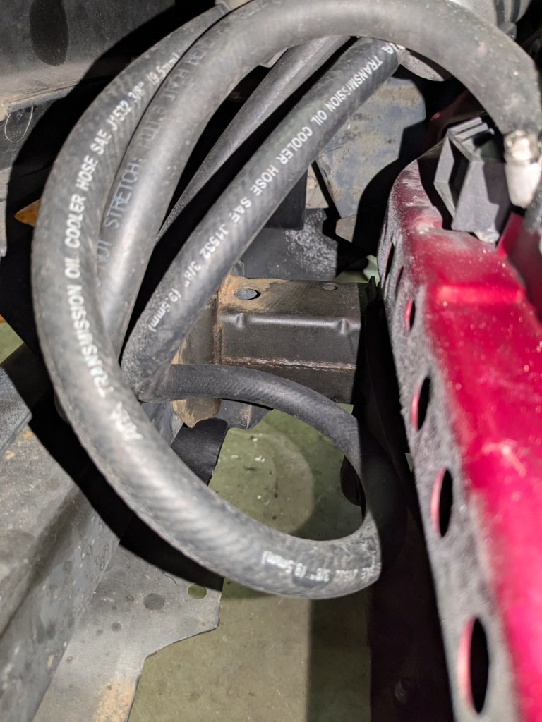

    1. The kit says not to cut the transmission hoses and found a post on I believe a Nissan forum that someone cut the lines and he ended up losing a hose on the highway. But the lines are way too long and I have them awkwardly coiled in the bumper. What is the reasoning behind not cutting the hoses? They are sold in bulk at parts stores so I imagine you can cut those.

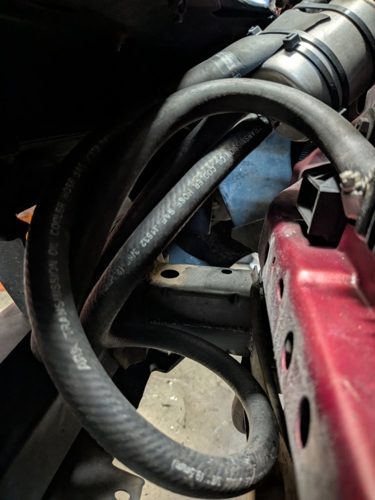

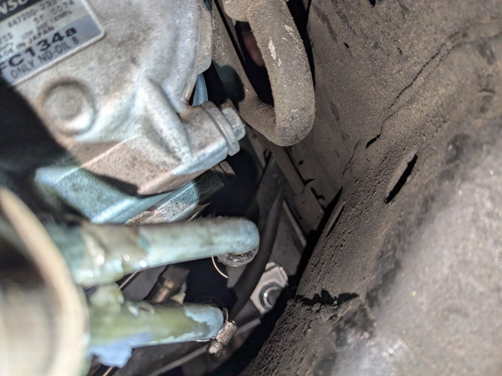

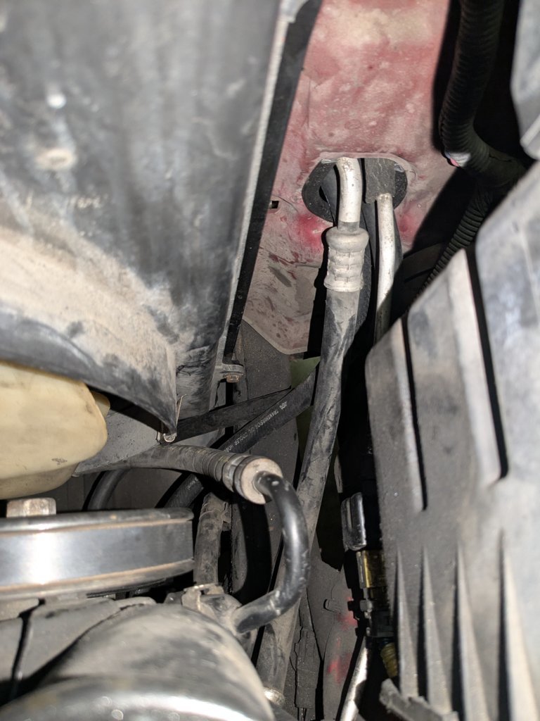

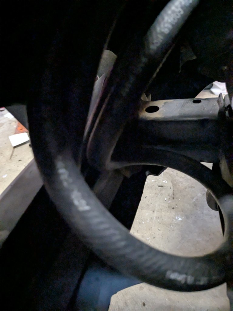

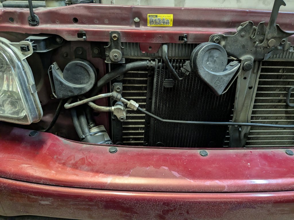

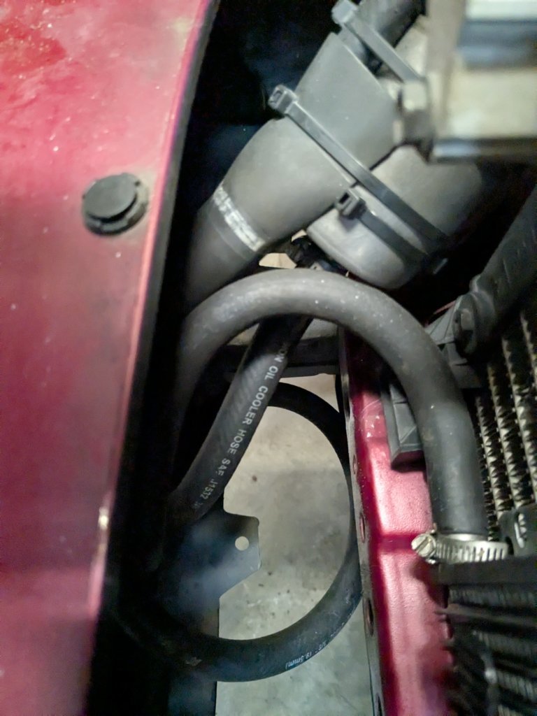

    Yes you can cut the hose, just make sure you make a clean straight cut and secure the ends well. If using hose clamps re-check after it has warmed and cooled.
    post some pictures of your install so we can look for potential issues.

    Coil hose is the best way to create flow restrictions and starvation as fluids may not be sufficient.
    cut it and make it as short as possible

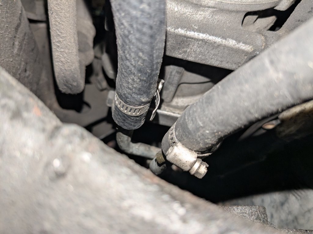

    Not the clearest photos, but I checked the filter is in the correct orientation and there are no kinks in the lines. The send line is going to the top and the return line is coming out the bottom.
    I'll be trimming the lines and moving the filter inside the engine now that I know that is ok. PXL_20250104_222447460.jpg PXL_20250104_222503746.jpg PXL_20250104_222513493.jpg PXL_20250104_222526397.jpg PXL_20250104_222545128.jpg PXL_20250104_222611505.jpg PXL_20250104_222818811.jpg PXL_20250104_222910263.jpg

    You’ll have no issue cutting the hose to the correct length.

    Those instructions are a bit confusing.
    What they are saying is to leave the hose in a "loop" until you have the cooler attached where you want it.
    Then cut the hose to the right length.
    "QUICK-CONNECT COUPLER INSTALLATION FOR USE ON VEHICLES WITH 5/16” STEEL LINES:
    8. Install Quick-Connect coupler to radiator using appropriate male or female end.
    9. Position hose loop next to Quick-Connect fitting and cut hose to length. Slide hose clamps onto hose loosely. Push hose onto Quick-Connect fitting at least one inch.
    10.Position remaining hose next to disconnected transmission line and cut hose to length. Hose should be cut to fit at least 1” past flared end. Allow a minimum 3” radius on all hose bends.
    11. Tighten hose clamps."
