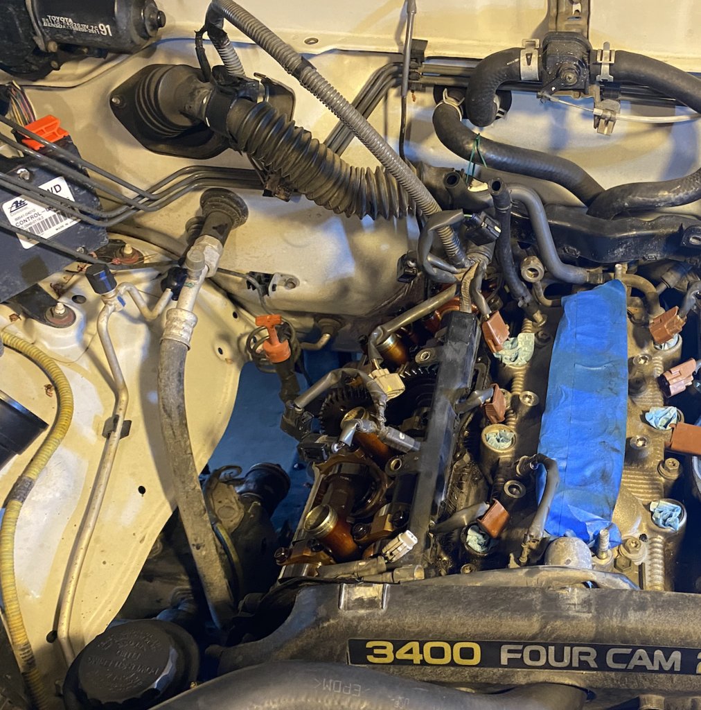

    Assuming automatic- the transmission dipstick should be on passenger side, near the back of the engine bay.
    It's the one with the orange/red cap - easily seen here from when I did my valve cover gaskets:
    .. If you have a manual, I don't believe there is one...

    ah yeah, it doesn't have one. It's either full when the fluid hits the fill plug, or you pour a known amount in via the shift lever opening (with the shift lever and associated stuff removed).
    Edit- reading back up this post; the advice given about disconnecting the drain line, and the link to the flush video are for an automatic transmission only, and do not apply at all to a manual transmission. For a manual transmission, you just do a drain and fill with the appropriate gear oil (NOT ATF) (mt90 I believe, but you should look that up).

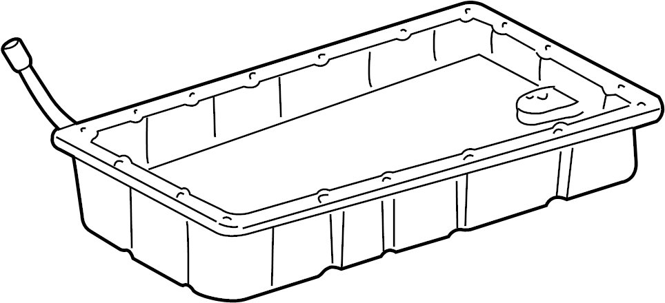

    Trans Dip Tube.jpg Picrture I took today of the tube for a dipstick.

    I don't have the tube for the dipstick to go in.
    The picture is of the tube, but, it stops way down. Almost under the engine.

    I think the question you gotta ask at this point is, if another member with an AT 04 has the dip stick or if the in the 04 model year toyota switched to a "sealed" variant. maybe @gearcruncher could answer that question.

    Can 100% confirm 04 Tacomas a340e/f came with a dipstick.
