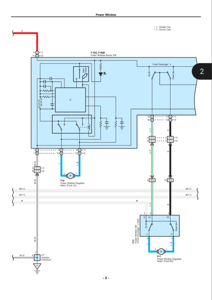

    I’m trying to upgrade my 2015 Tacoma TRD sport access cab (2 windows) with auto up/down window switches. Apparently they don’t have the 2 switch upgrade for it only the 4 switch (4 door). Well, the 4 switch panel plugs right up but doesn’t work. I’m sure the pin out is different as to why. Any one have the schematic for the 4 switch panel and the wiring harness to make this work?

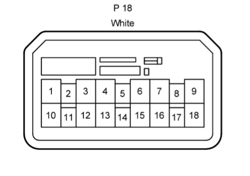

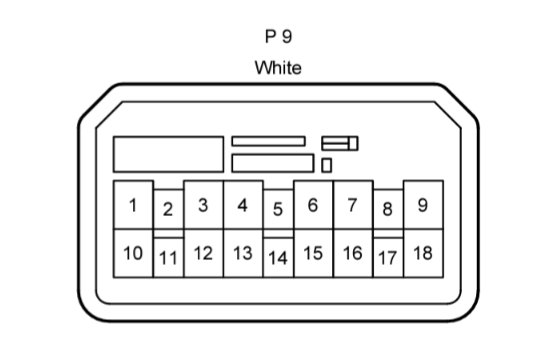

    Connector P9 - double cab
    Connector P18 - access cab
