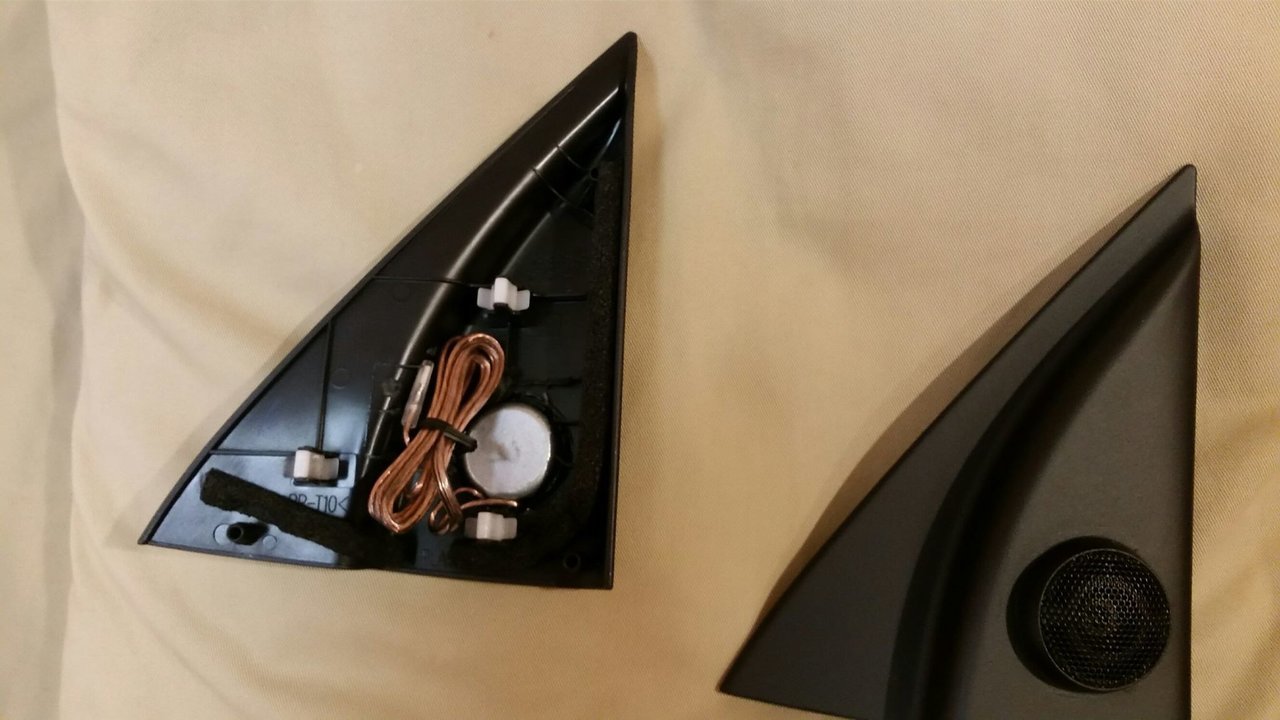

    I went with Components up front and Coaxial in the back. Put the Tweeters in the black triangles that cover the inside mirror screws. Sounds amazing.

    I just used a hole saw a little smaller than the tweeter, and used super glue to make it stay. Taped off around the tweeter and used flat black spray paint to make it all blend in. Soundstage is really sweet
