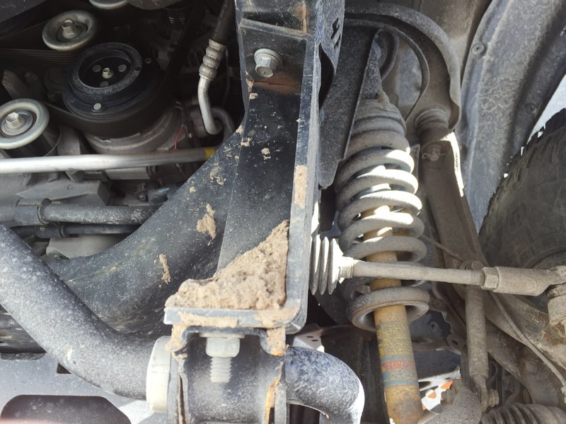

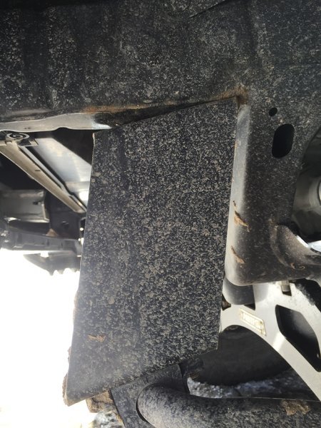

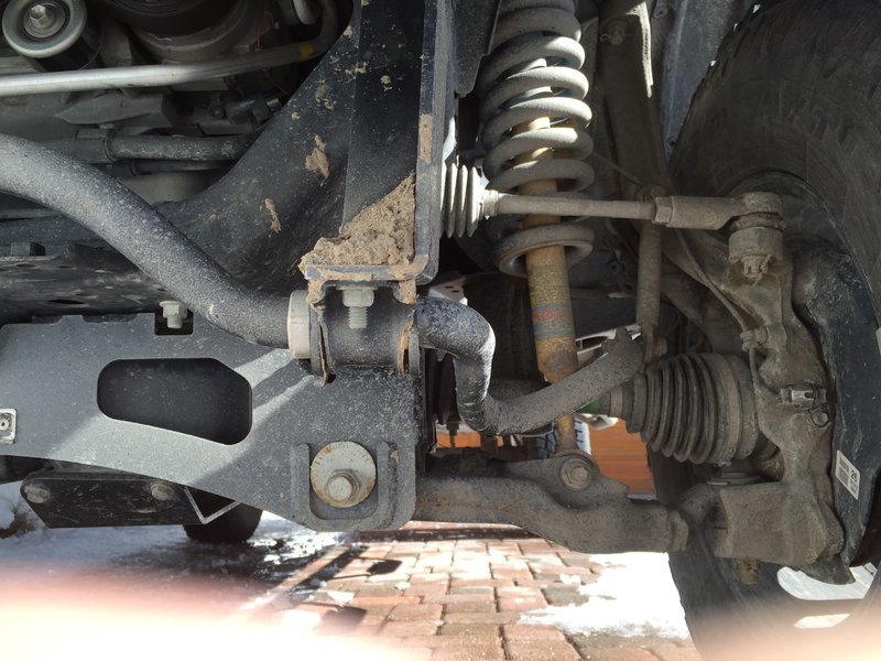

    Just wanted to post up a couple views of where the drop bracket for sway bar hit and bent, I'm really struggling to actually see where they say my frame is bentimage.jpgimage.jpg image.jpg

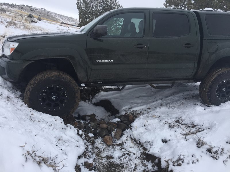

    This is the ditch it packed into
    The front end was in the ditch, I 4 lowed w rear diff lock to move forward, we then built up the ditch w some rocks the then reversed out, I'll try to post the video

    I'm seeing damage to the lift kit, not the original frame. Am I wrong?

    thats what I'm sayin koditten...I just don't see the frame damage but I've had two different body shops tell me it is, by about an inch

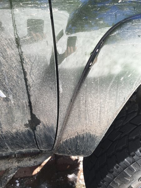

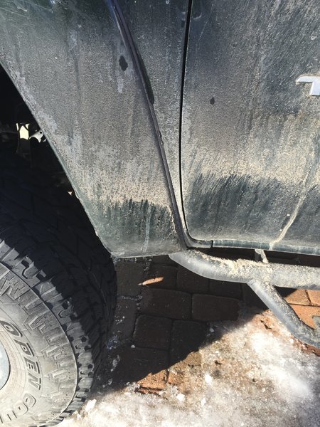

    Door gap looks pretty even, if it was truly bent an inch, I doubt you would be able to open the doors. With the hood, you might of just shifted up the core support.

    Koditten-my insurance preferred body shop does not, the manager there says he would have a "frame straightening shop" down the street do the straightening $1000 and then he would weld the new "anchor points" for fenders and fix for $3000 and be almost new. This is if the truck is totaled by my insurance. image.jpg
    Here is the left and right door gaps the left is a bit tighter than the right, everything closes fine

    That door gap change is nothing. That is pretty common for front end contact. Evetything gets pushed back because it's only sheet metal.

    • 3-5 mph to this ditch can not cause any frame bent, or then the 6" bracket lift kit is designed very badly, way too fragile truck to use
    • if there really is a bent frame, it is caused by the lift kit and should be definitely possible to straighten in any decent body shop
