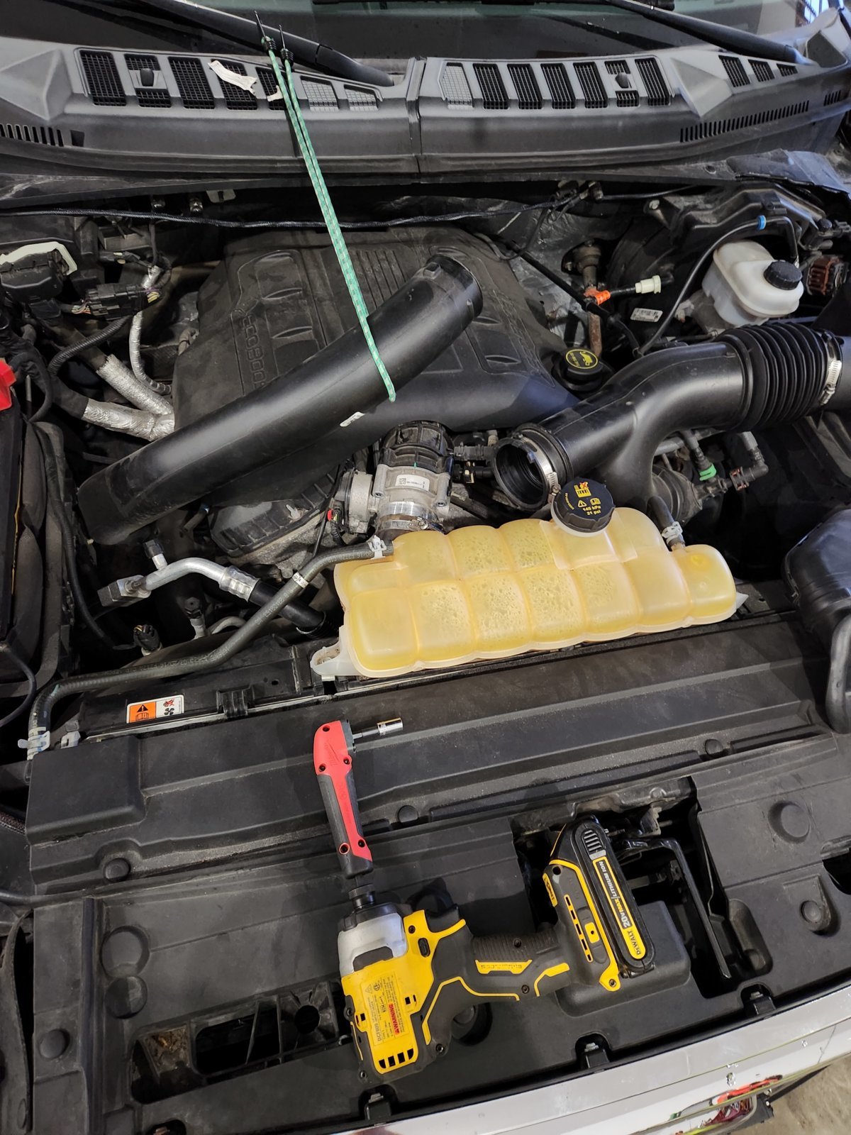

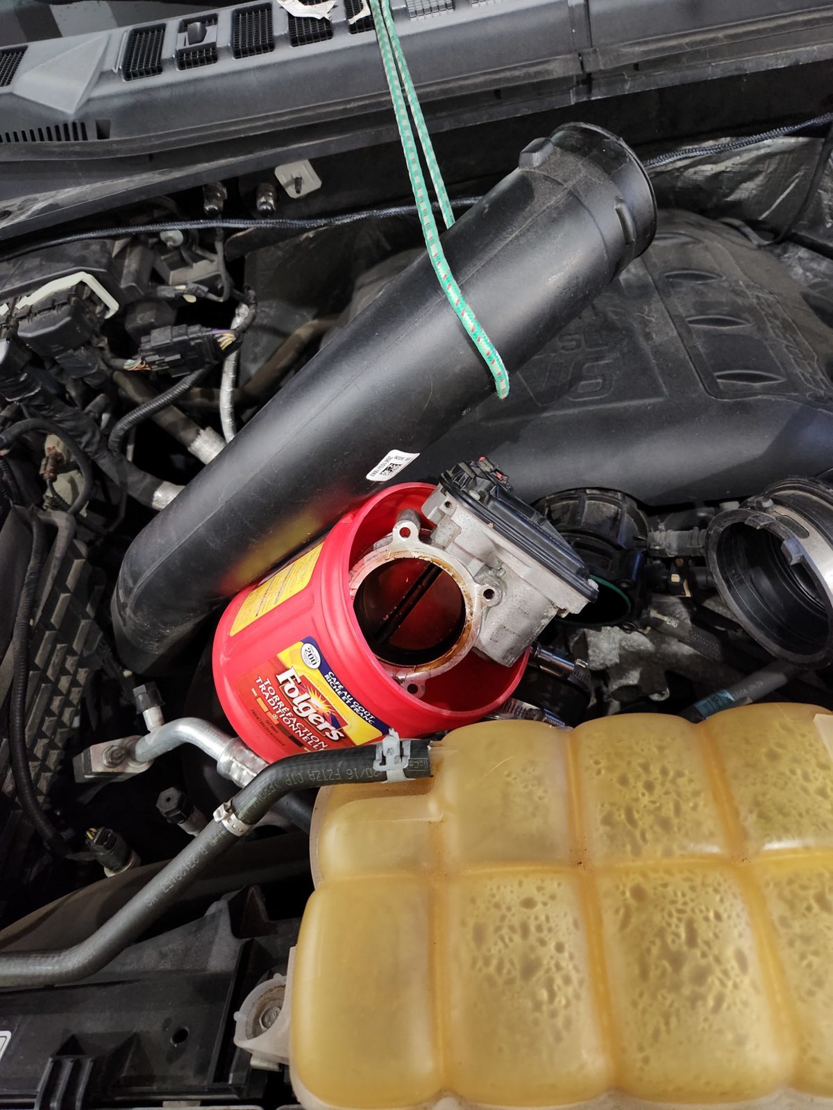

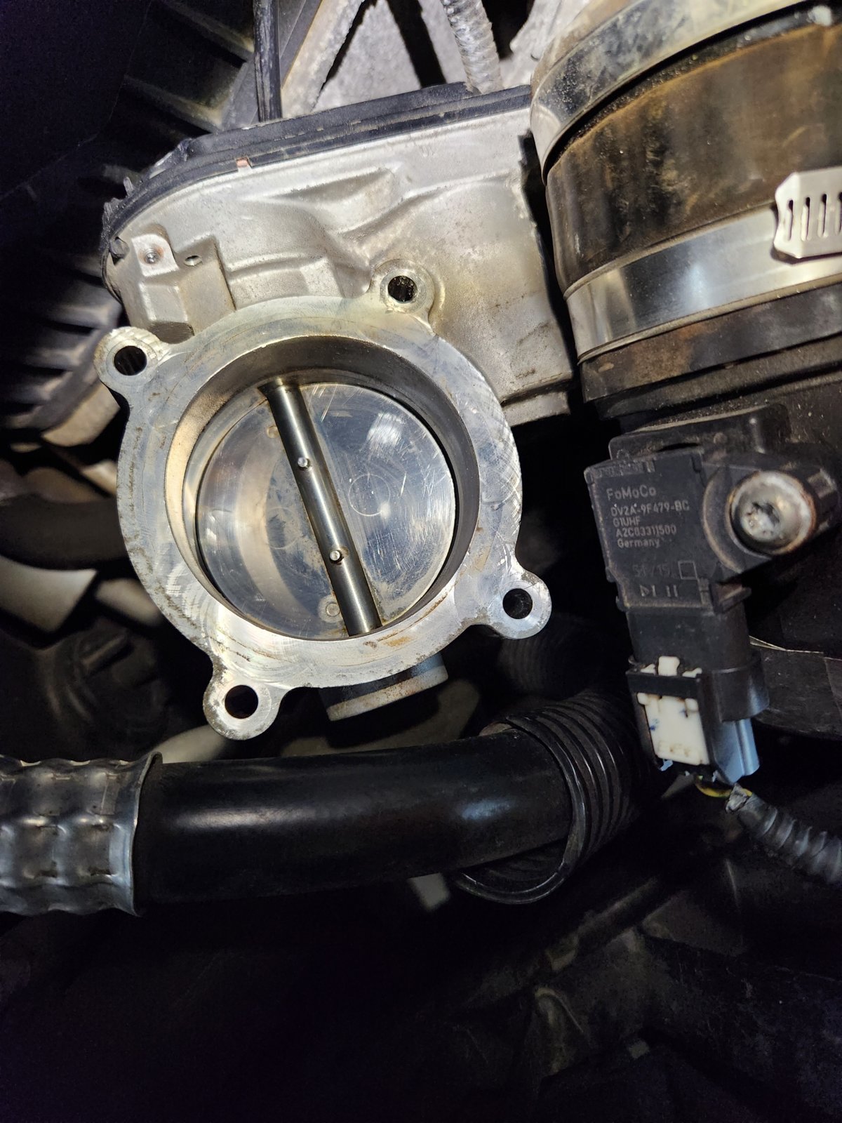

    The throttle body like stated above is an easy thing to clean. Just so happened I cleaned my F150s TB this afternoon :):laugh:
