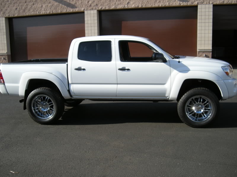

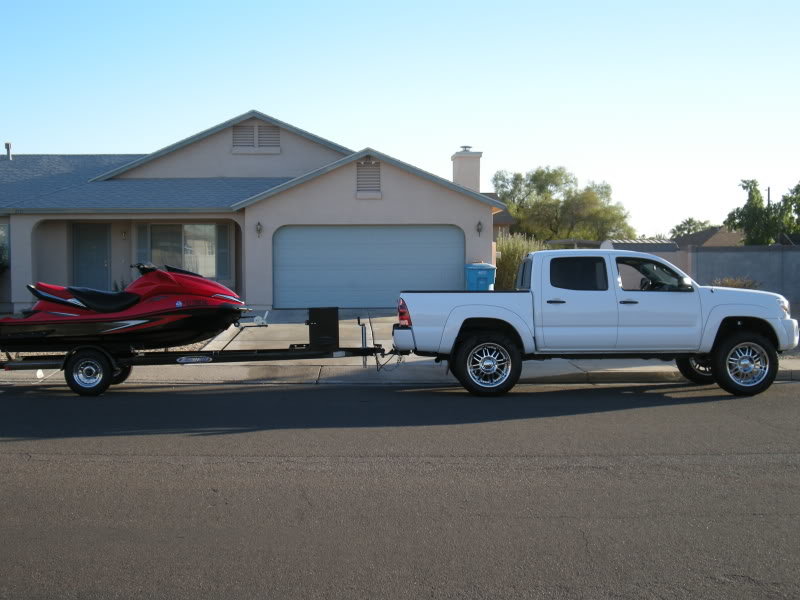

    20X9 KMC Backseat

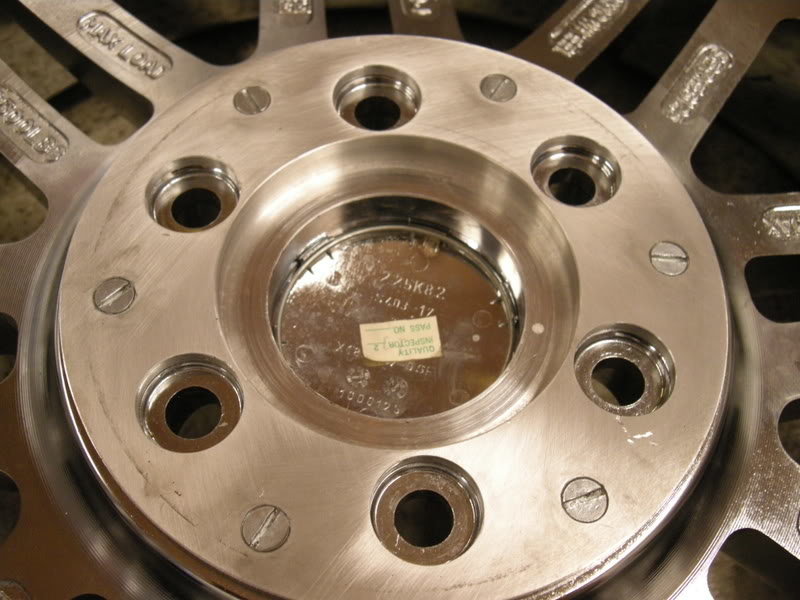

    I ordered the wheels from ebay with a 78mm bore....oops

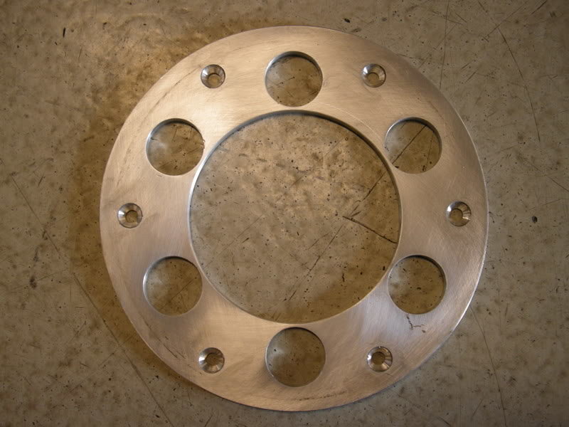

    The hub sticks out ~11mm but I could not bore the wheel out that deep or it would hit the wheel spokes.....so my buddy made spacers from 1/4 aluminum plate....
    Then bored out the wheel to 106mm, 6mm deep....giving a total of ~12-13mm depth when the spacer is installed with the 6 mounting screws.

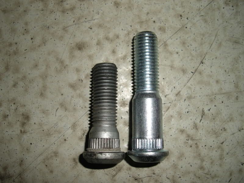

    I did a 3" AAL lift and installed 15mm longer wheel studs to account for the thicker wheels and spacers.
    A bit harder than just a bolt on....but I think it looks good.:D

    how is the handling? accelerations and stopping?...btw, they look good on your truck for some reason...
  10. Oct 13, 2008 at 8:52 PM
    Gen3Benz
    Gen3Benz [OP] Active Member
    Sep 13, 2008
    #9203
    27

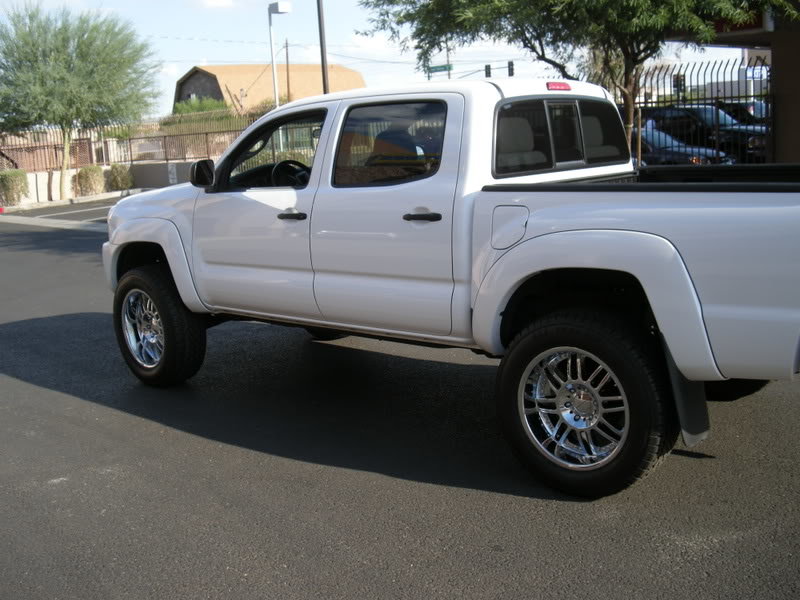

    Handles better
    Notice a little bit sluggish out of the hole, but not too bad
    Braking feels the same.
    Pulled my 2000+ lb ski and trailer over 400 miles and it had zero problems.
    Wheels and spacers are hub-centric and balanced together, no problems.
    I do have a bit more annoying bump steer than before the lift, I had it aligned the next day.
    Are any correction kits available?
    Maybe drop the center link a little to correct the tie-rod angle.

    You gonna take that off-roading at all? Hope not! What's with the little dent above the rear wheel on the passenger side. Sorry I noticed it.

    good eye.
    Yeah thats a dent.
    I go offroad quite a bit....but do dirt roads count? :D
    Its 2wd, they are made for asphalt anyways...haha
    Oh, all my vehicles are white....white is right...haha
    Please dont pull the race card

    Now I need to find some 20's for my trailer....

    sweet pic!!

    I had just got done washing the truck and the ski...then it rained today....oh well

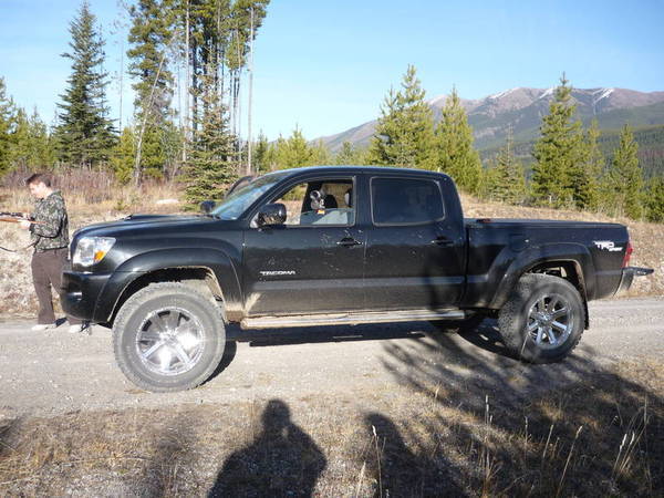

    2.5" Fox Extendable Coilovers, LR UCAs, Agri-Cover Larado soft top, Pop'n Lock, 48" Hi-Lift Jack, 20" Incubus Offroad rims
    Nice set up. I just bought my truck and it had 20 inch rims on it already. Do you have any problmes with rubbing? Mine rub a little when I turn the wheel to the max, but i have learned to live with it.
  20. Nov 9, 2008 at 10:22 PM
    #20
    Gen3Benz
    Sep 13, 2008
    #9203
    27
    I cut out some of the inner fender trim at the bottom front .
    Also trimmed a little bit from the fender flare...near the front....all the way on the inside....very small amount....no rubbing
