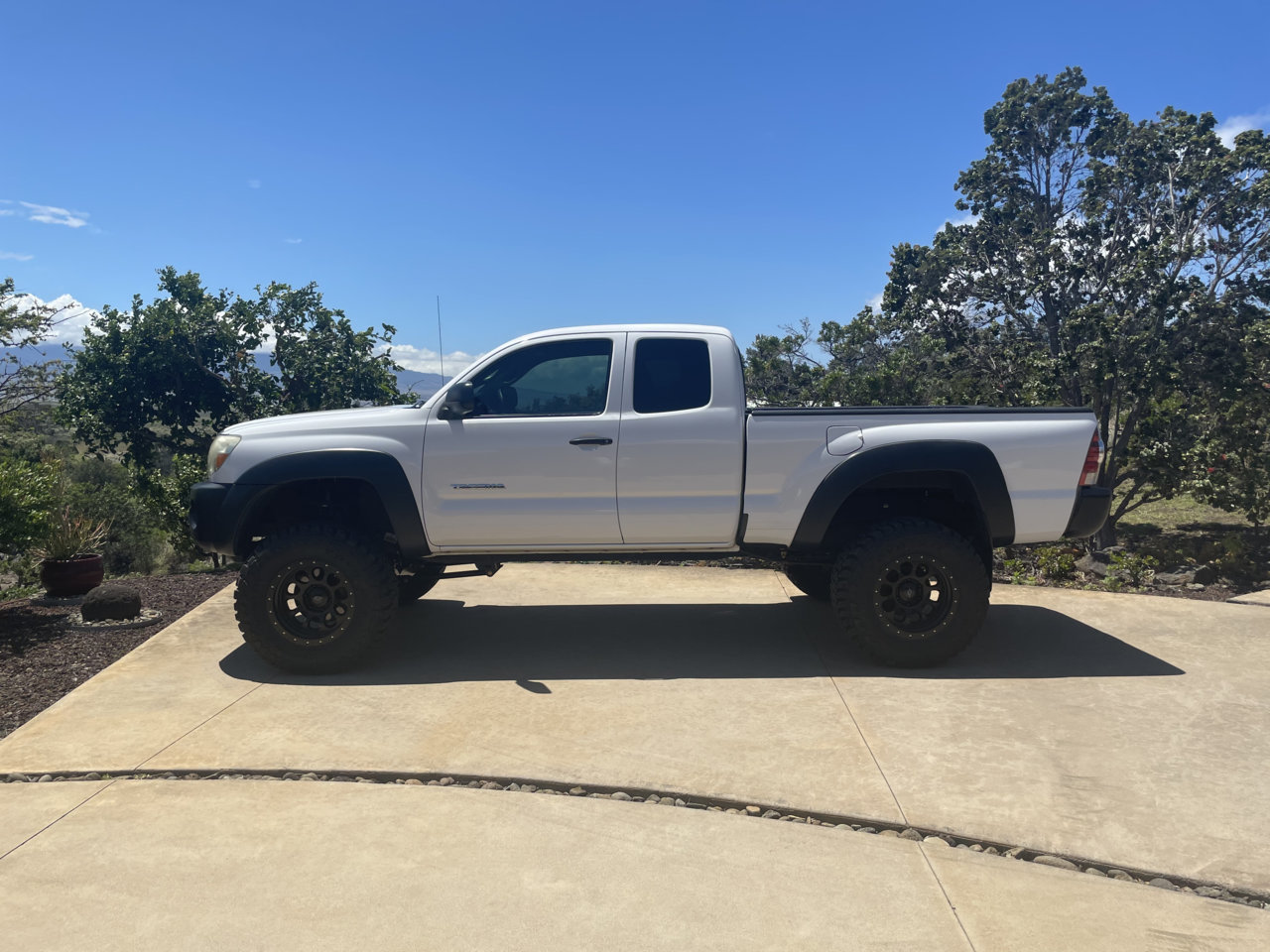

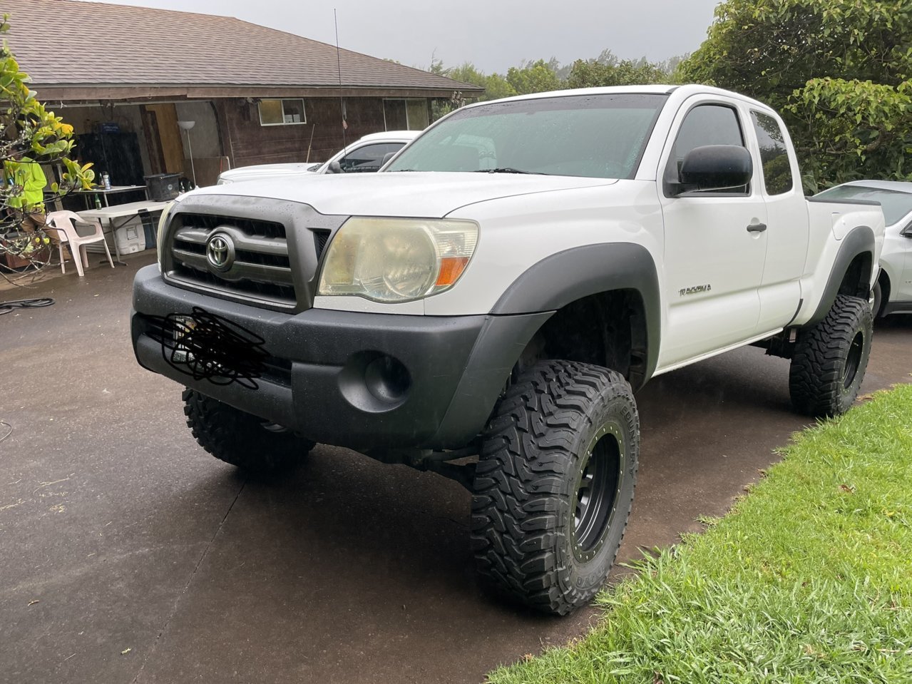

    I have a 6” lift and I run 17x9 with a -38 offset and 33x12.5 open country mt and I needed to trim my bumper maybe 1/2” on an angle to have 0 rub at all... I think any offset less than -38 you wouldn’t need to trim and it wouldn’t rub.

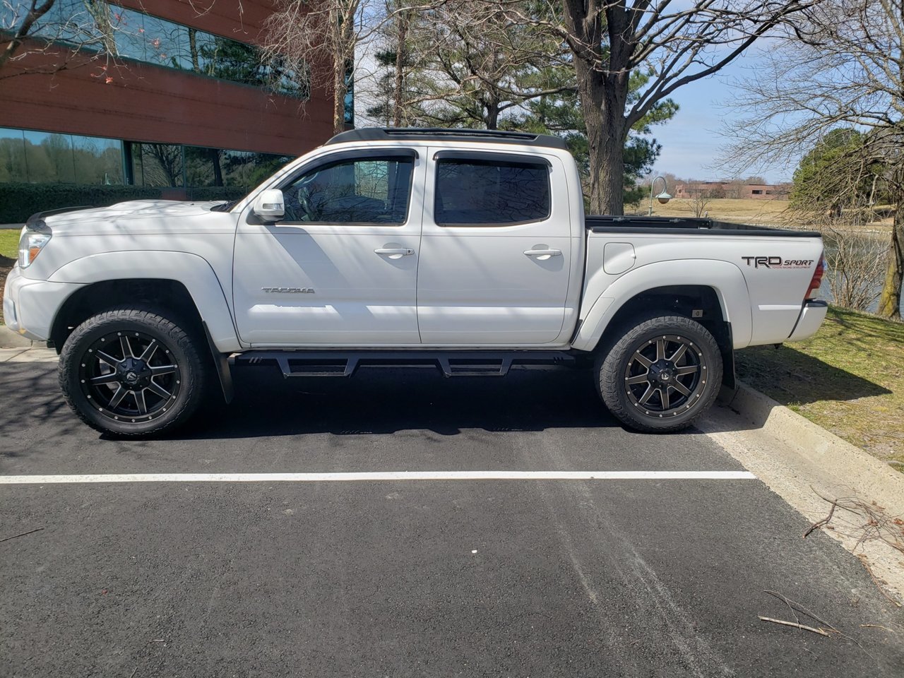

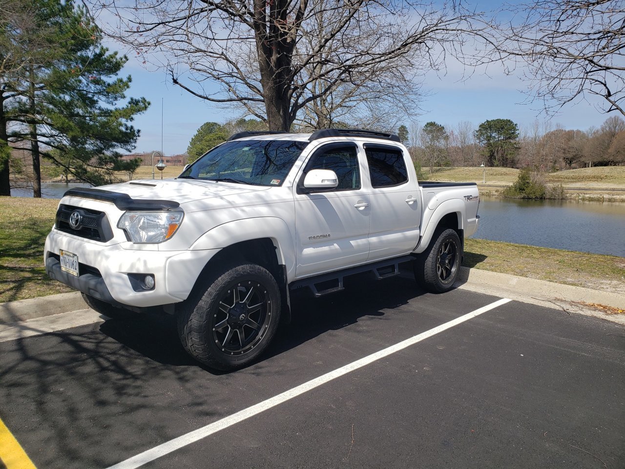

    I run a set of Fuel Mavericks in a 20x9 with +14 offset and 5.5" backspacing wrapped in Hancook Dynapro ATM 275/55-20's. I have Bilstein 5100's up front set to the highest clip and Bilstein 5100's with a 2" AAL in the rear. I have the ever so slightest bit of rubbing on the left tire. However, I only have the rub when I back out of my driveway and turn the wheel so I can go left after I back out. The ride is just slightly stiffer than it was with the stock shocks and 265/65-17 wheels & tires.

    Here are a few photos... I’ll have to take some new ones cause I got some new lights going in. 170E37B6-2F1D-42A1-BE28-B0670FBC1C52.jpg 51F0E602-B9CE-4898-8BC5-F3D127173AF6.jpg

    My truck is on 17x9s
