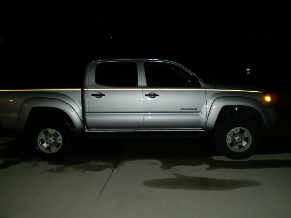

    P9040285_51e4894ad07e89dae09debe6e265927807b8cb08.jpgthanks for the pdf. I have been researching this since i bought my 08 Prerunner DC V6 SR5 auto tranny. I noticed the vibration a few days after purchasing the truck and hoped it would go away but it never did. It seems to have gotten a little worst after installing the 3" lift on the truck. I guess I can now call the dealer and see what can be done. And im assuming I should take the lift off before I go being that I installed it myself, then they can't try and BS me about mods being the problem. thanks!!! Will keep updated

    I called the local dealership and told them about the vibration and the TSB. They looked it up and said no problem bring it in ad we'll fix it. I told them I had a 3" lift installed, they still said no problem, but they couldn't guarantee the results being that it was lifted. But all in all im getting the new rear engine mount replaced next week. I will let you guys know if this helps. I have also been reading about the leaf spring TSB, I have the 3 leaf pack on my 08 and have no bottoming out issues even when towing a 20' boat. I think they may be redisgned. They have the 2 normal leafs and then a big one.
