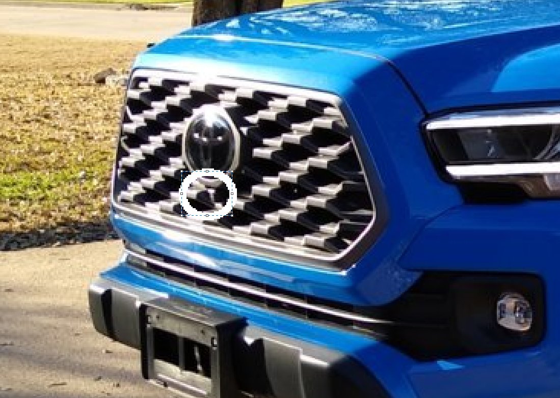

    You can install the camera on the stock OffRoad grille. My truck came with the camera, and this is what it looks like:
    Paul466[QUOTED][OP] likes this.
