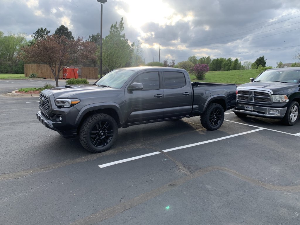

    IMG_5865.jpg I run 275/55/20’s on 4Runner rims. Stock height no rubbing. And people ask me about “my lift” all the time. Also, it changed my odometer to showing 3% fast on my stock rims to 1% slow now so hardly noticeable.
    JPTx and turkeyslayer66 like this.

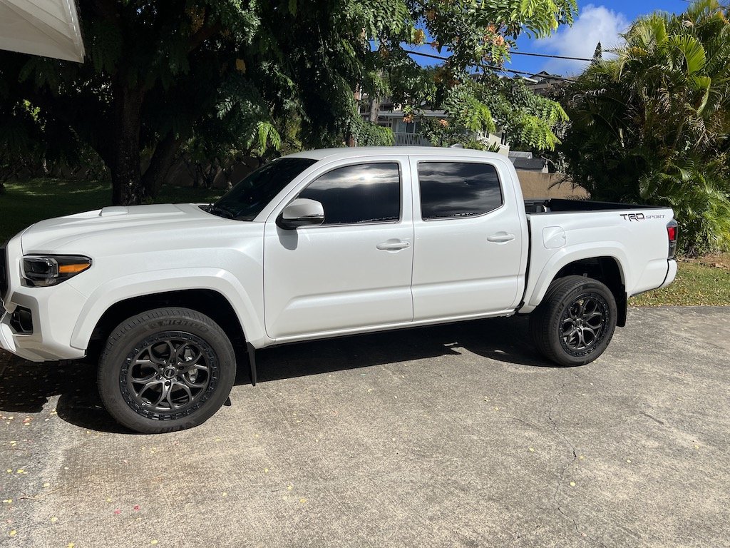

    Here's mine with 20s.

  11. Aug 24, 2024 at 5:24 PM
    turkeyslayer66
    turkeyslayer66 Well-Known Member
    Sep 13, 2022
    #405718
    283
    mike
    22 AG Trd Sport
    I really like how they look on your truck, very nice!
