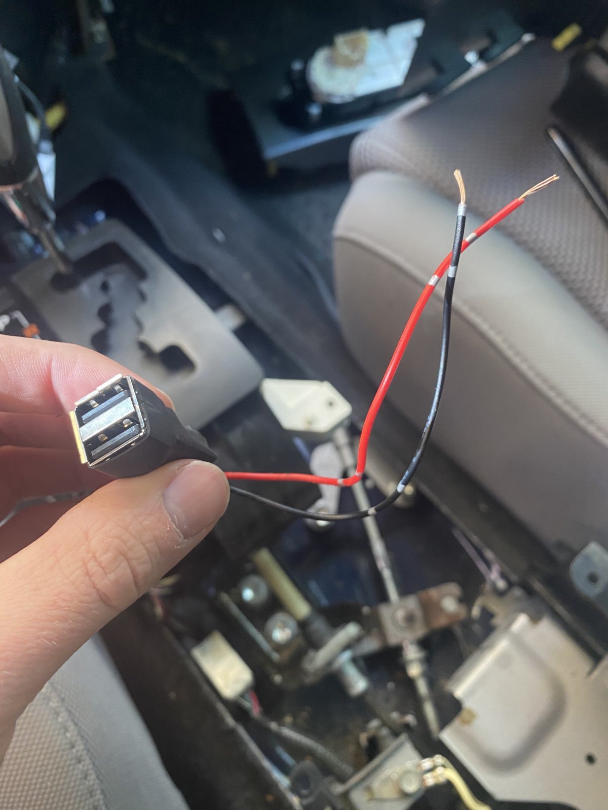

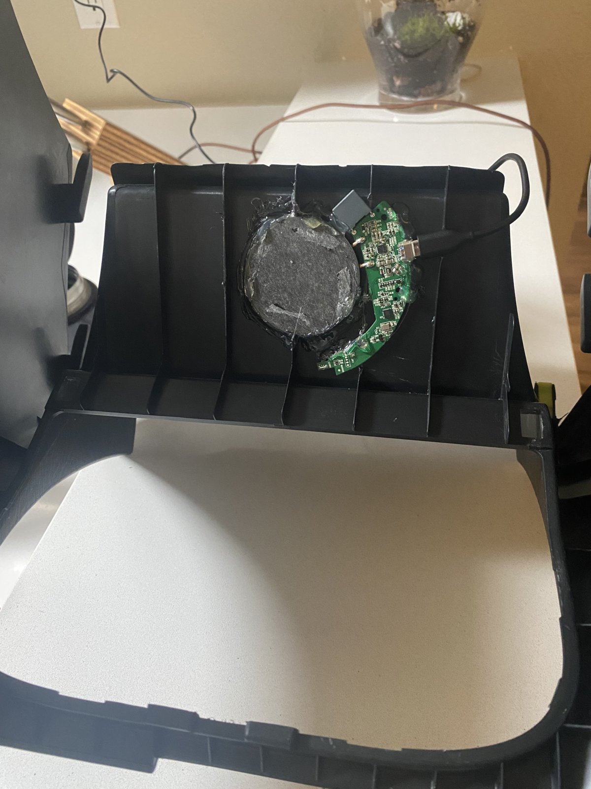

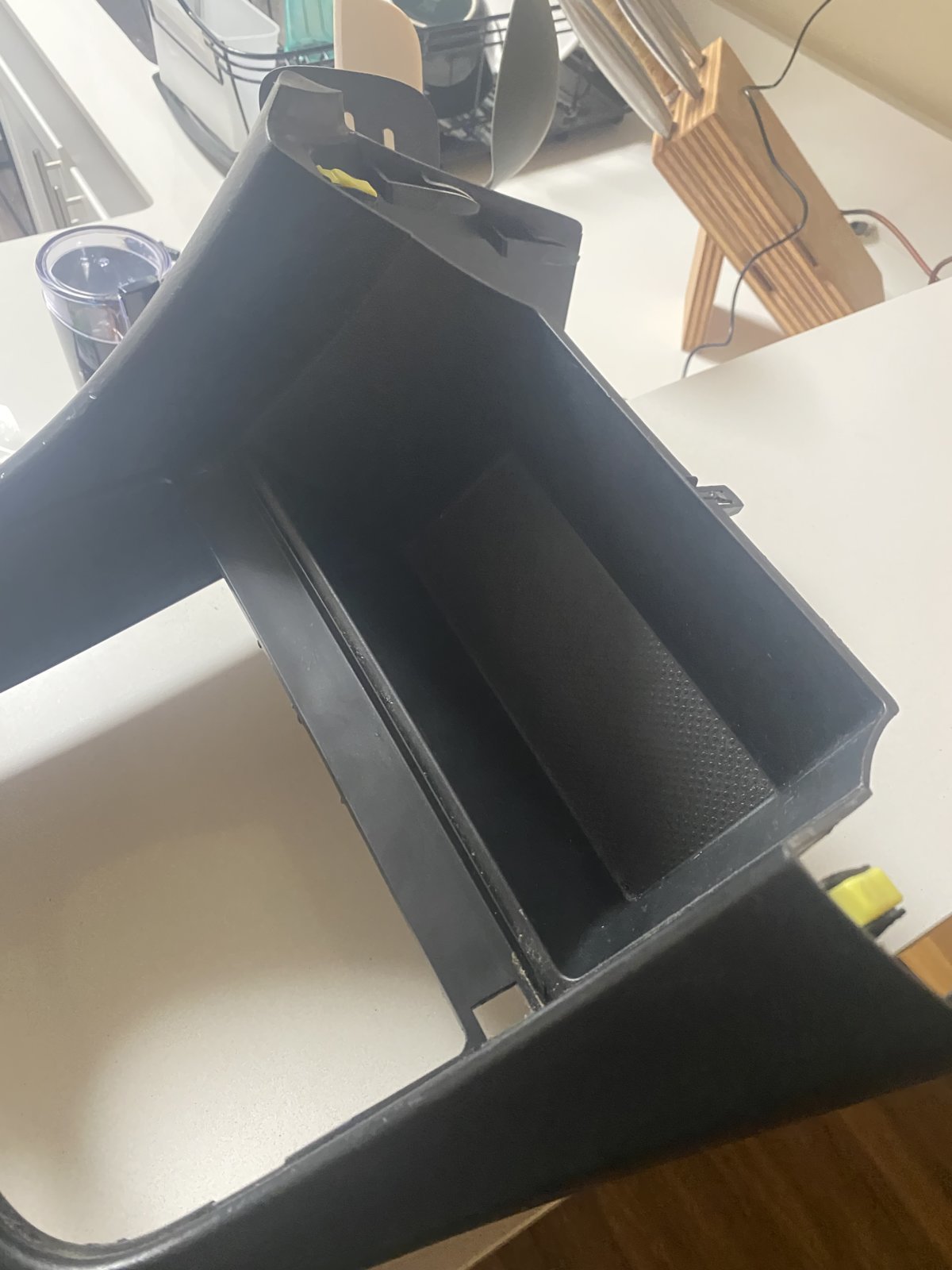

    Wanted to share my wireless charger setup. The compartment is the perfect size so that my phone stays charging even if it slides back and forth. Wireless chargers require the data wires along with the plus and minus in their usb cables, so i had to plug the cable from the charger into a cigarette lighter adapter i tore open. Then i wired that to the back of the cigarette lighter port so it looks completely stock when put back together.
