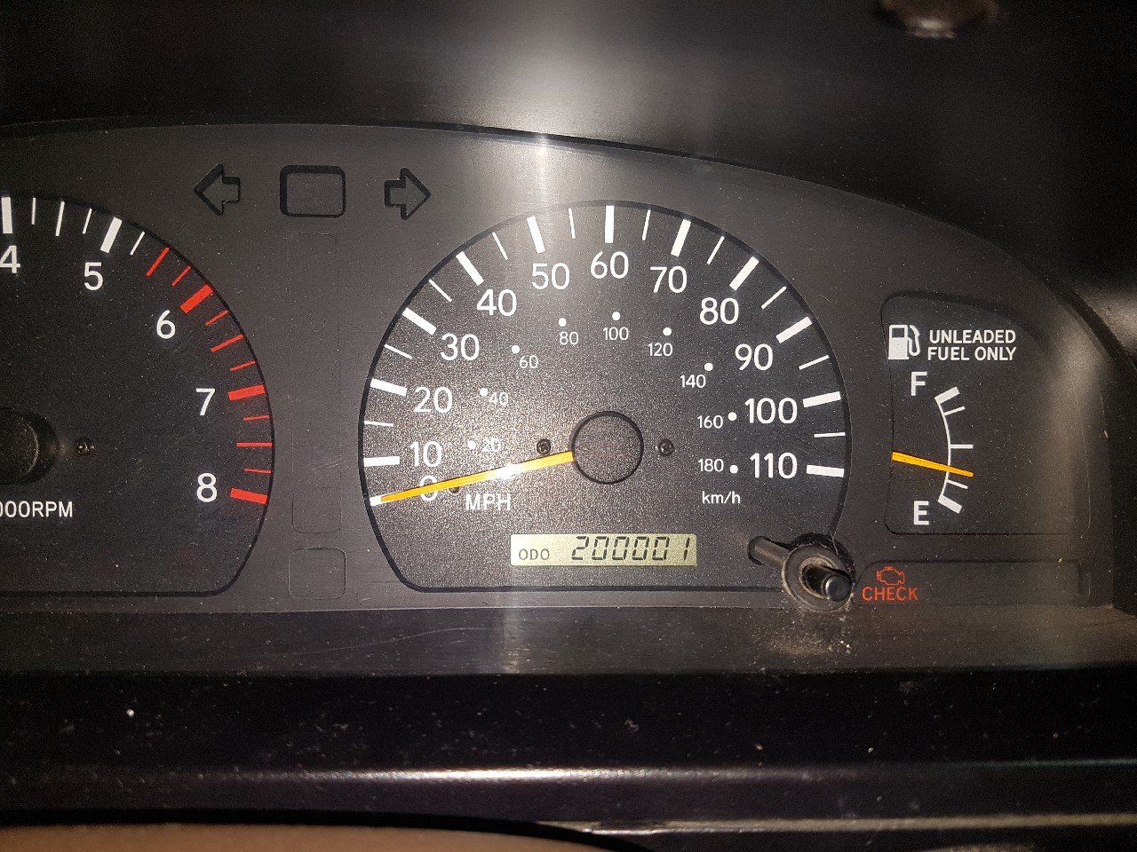

    Anybody know what would cause this?
  7. Sep 12, 2019 at 4:43 AM
    #927
    jakec89
    jakec89 Well-Known Member
    Sep 10, 2019
    #304850
    120
    This is what I’m referring to.

    Just rolled into the garage. Yay, I'm in a club!
    tacomakid96 and GQ7227 like this.
