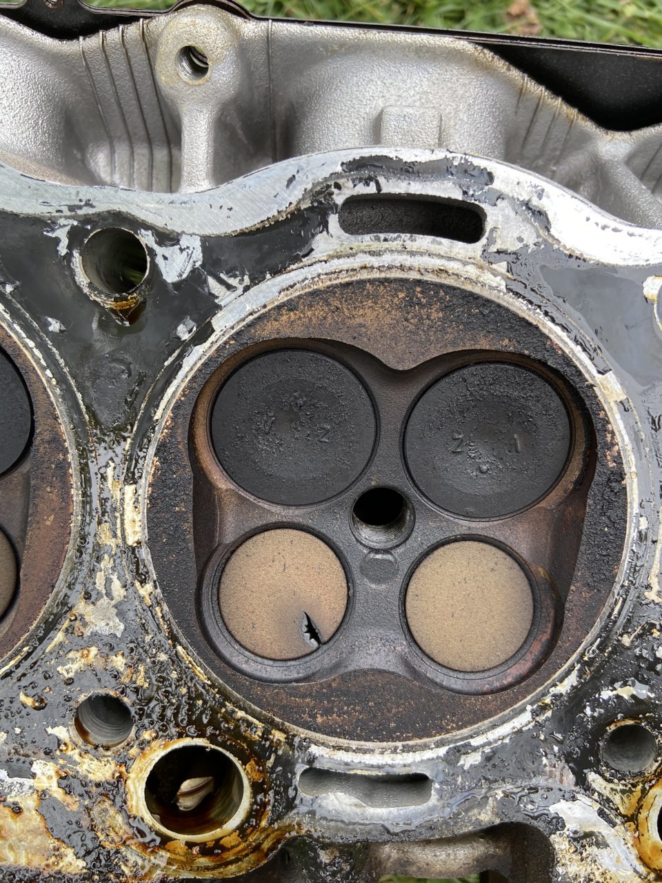

    pulled this yesterday... Think from water maybe.. not sure of history of truck.... 235kIMG_0720.jpg

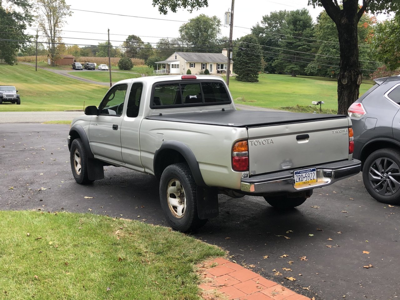

    31F6B37C-E8A7-491F-BED0-C51BB548925A.jpg Over the summer I bought a 2002 extended cab 4x4, from the original owner, who I’ve known since long before the truck was new.
    It has 240,000 on the 2.7 with an automatic trans. i had to immediately replace the front struts, and rear shocks. As far as problems:
    1) the trans has a whine whenever in gear-(don’t know how long ago it had a fluid and filter change)
    2) Under part throttle, it has a severe stumble. I plan to check the plugs, but I suspect it’s going to be fuel injectors.
    3) I did a search for fuel filter location: it should be next to the transfer case, under the driver’s seat, correct? Well, it’s not!
    4) check engine light- had the codes read and it shows P440,441,446.
    Being an old school, small block Chevy guy, this is all new to me. I bought the truck to be an “occasionally driven parts hauler”, but I’m enjoying the heck out of my $500 investment, and it’s now my daily driver for my 10 mile round trip to work.
    Here’s a pic I took on Sunday after installing the tonneau cover.
    Sorry for the long post- feel free to comment on 1-4, PM if that’s a better route to follow

    $500 is the deal of the century. Looks great, maybe Rattle can/update the rims or lots of inexpensive Aluminum wheels available at junkyard if you want to go that route also.
    #1 Change the fluid and filter
    #2 Start cheapest/ Clean mass airflow sensor first
    #3 Fuel filter/ Google search says it's on drivers side of motor and access thru wheel well. Difficult to change from what I've read. Clogged filter could be big part of your stumbling problem.
    #4 Lots of people on T/W have chaser these codes https://www.tacomaworld.com/threads/p0440-p0441-p0446-trouble-codes.200359/ At $500 purchase price I'd start with a new gas cap. If that doesn't work just put a piece of black tape over it and drive it.
    Good luck with your $500 Queen

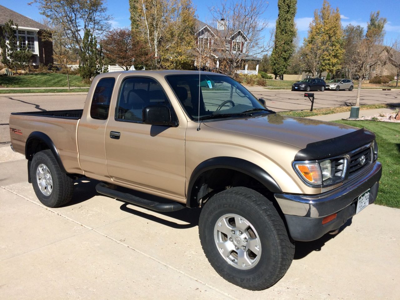

    Quite a lot of nice trucks here.
    Been watching over the years and joined TW in 2018.
    Just now getting around to posting.
    Figured I better jump in before I leave the 200,000mi zone.
    '95 Tacoma with 294,827mi (We have had it for about 6 years, since about 225,000mi):
    99 4Runner engine complete with computer for code reading (probably around 185,000 on the motor).
    07 Tacoma rims
    Hella headlight housings (so can change bulb from rear instead of removing the grill in February!)
    Westin side steps
    Mid generation 4Runner electric heated side rear view mirrors - mirrors on - wiring in progress
    Bushwhacker fender flares

    #3: the 3.4L filter is under the driver seat area, but the 2.7L is a bit tougher location.

    I just did mine a while back and in my opinion, it wasn’t as hard as many people say. I saw a guy on youtube do this: started by taking the line that goes from the filter to the fuel rail off at the rail. Then i snaked it out through the plenum still attached to the filter. After releasing the filter from the engine block, you can just pull the whole assembly up to where you can work on it. Dont get me wrong, it isnt like changing an air filter but it’s not crazy hard. For what its worth the fuel in my 196000 mile old filter was pristine, and it was driven 12 miles a day on a dusty dirt road for most of those miles.
