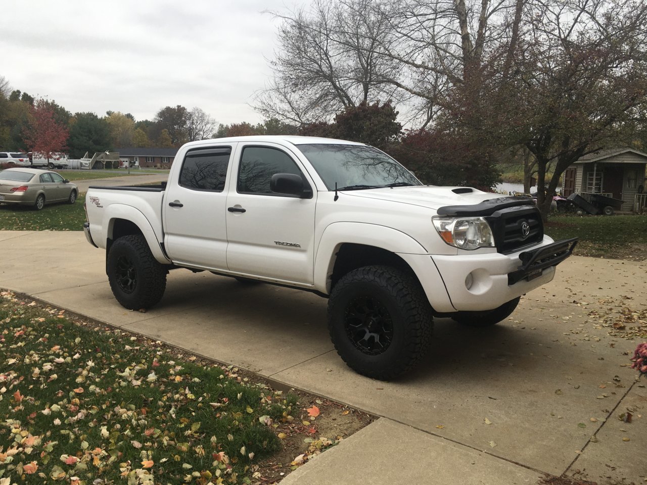

    Just got done with my 200,000 reset on my 2008 ..
    Guess I’ll go from front to rear with what I replaced and did ..
    polished head lights , replaced fog lamps ..
    spark plugs , clean MAF sensor , air filter , wiper blades and fluids as required ..
    Struts , wheel bearings , CV shafts , lower ball joints , rotors , pads and caliper pins and rear shocks ...
    pressure wash everything while it’s torn down , hit the brown scaley stuff with a wire wheel ..
    Change gear oil in the running gear ..
    brush POR on the frame , shoot every thing else with undercoating ... everything is either new or painted when it goes back together...
    new tires and wheels because it’s time , off to the Toyota store for alignment...

    what's that covering your front license plate?
  5. Oct 30, 2020 at 7:34 AM
    #25
    jhinderliter
    jhinderliter Well-Known Member
    Oct 22, 2015
    #167393
    137
    West central il
    2009 Double Cab TRD Off Road
    N Fab mount and Rough Country light bar..
