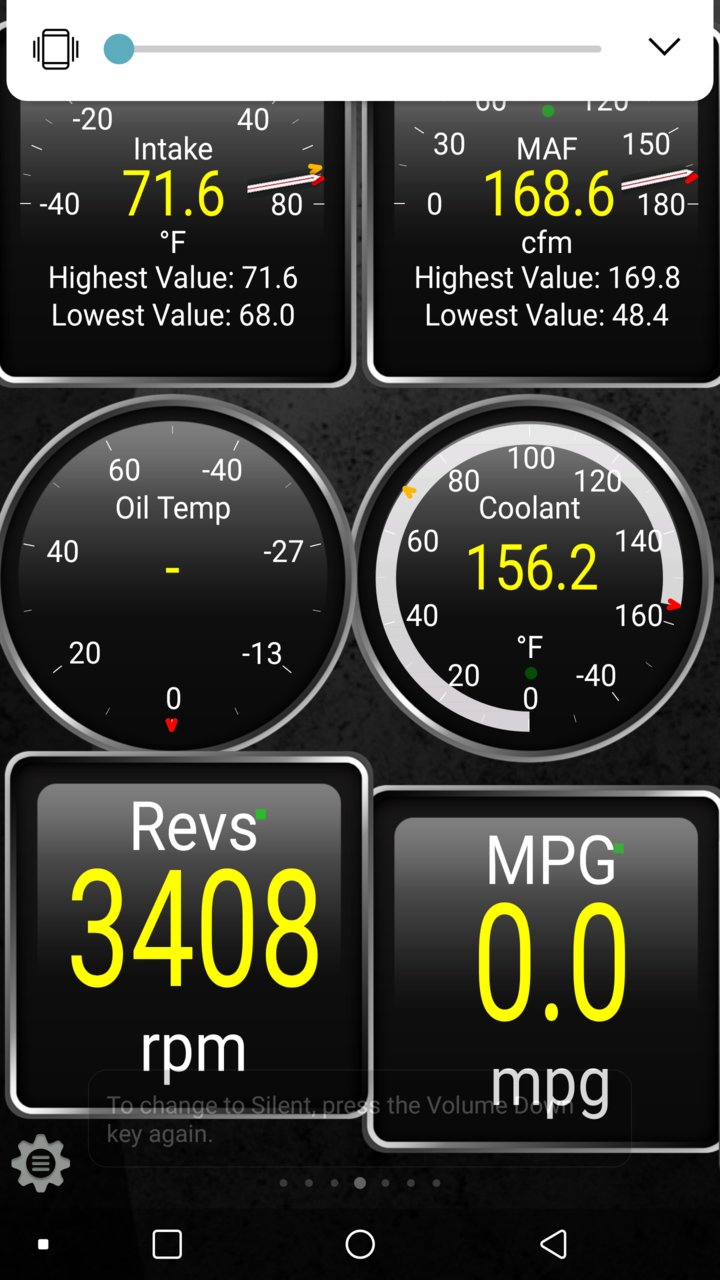

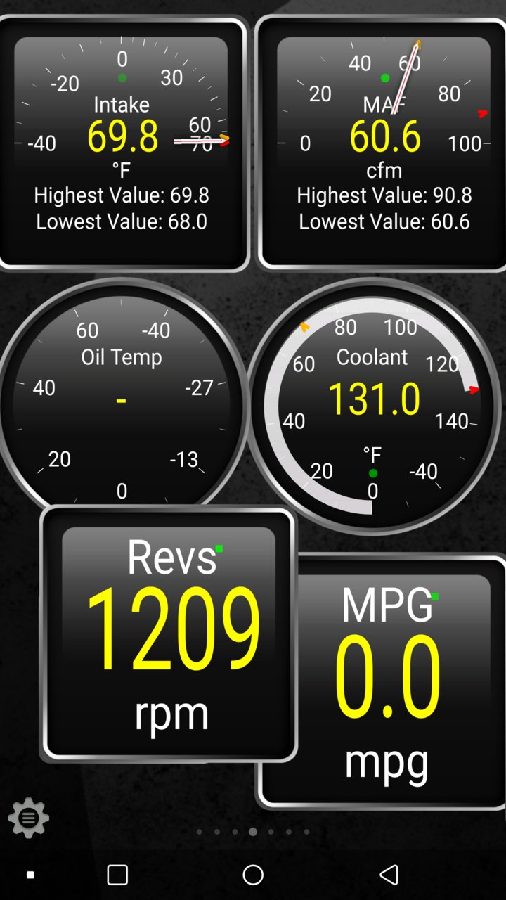

    60 - 170 CFM ~= 35-98g/s
    So it seems that you have a restriction, or a bad MAF like the guy above said.
    Since you're stuck in open loop anyway, take your cat off and unplug your O2 sensors. Rule that out, then buy a new MAF.
