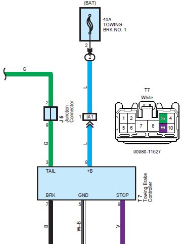

    Sounds like a crock of shit, the only tie ins to the vehicle systems for the Aftermarket brake module is the brake circuit input and the dash illumination circuit (+).
