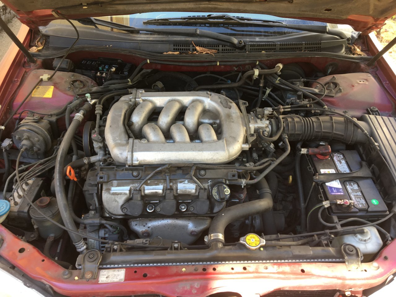

    You have a later version of the v6 hence the COPS, now it is a matter of finding the no spark culprit. Now that I see the engine, find a service manual online so you know the values of the sensors you will test. Start with the cam position sensors. They basically run the show. Next would be the crank sensor. Check the ignition lock cylinder for looseness....hence the reference to how many keys.
    Depending on price, you could throw in new cam sensors and see what happens.
    Besides the ecu and relay, those parts are about all that operate the actual spark.
