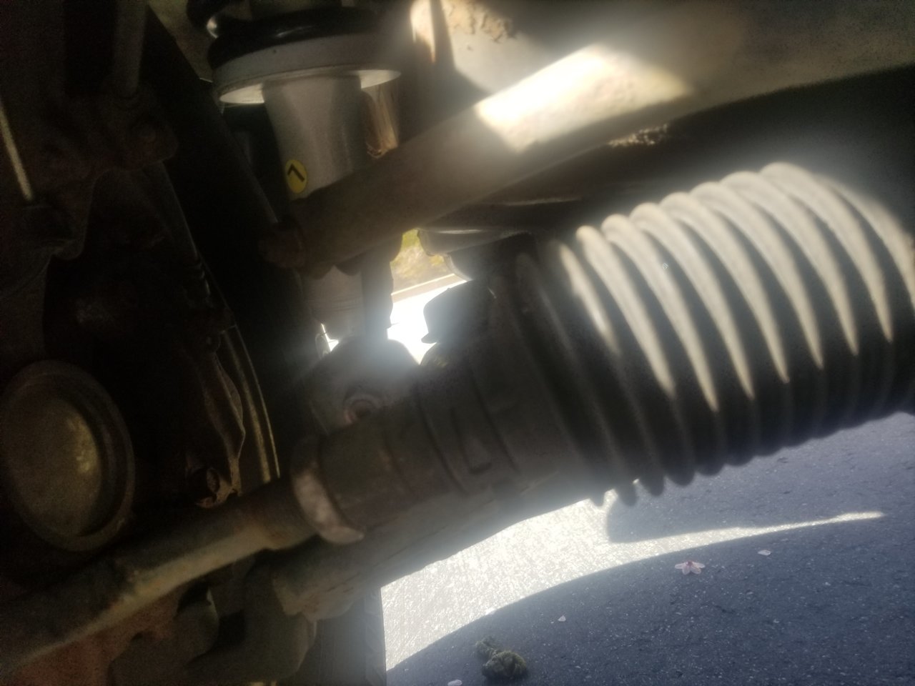

    Guys, should I get the extended sway bar end links from Napa?? The bar is tilted down a bit so I am not sure

    Why? Your Tacoma was designed to use what you have on there. I still have my stabilizer bar on the truck and use the exact same end link part number it came with. No issues.
    The OP had a 2000 taco, those end links are different from what’s on yours. Completely different design.
    skip it.

    Area, okay I wasn't sure since I have read posts on this site talking about the OG end links too short and binding after lifting the front end. Mine seem to be okay and just thought I would ask the experts

    Also, your PreRunner uses part# 4881104110 (stabilizer bar). The 2000 taco uses part# 48811AD010. Two different part numbers and possibly designed differently. I can't be certain since I don't have the two to compare side by side but the part#s are different. Also note that toyota shows it doesn't fit on anything after a 2001.
    So what does this mean? Maybe those longer end links might put added stress on the stabilizer bar or other components? I really don't know. Worth pointing out though. Good luck.

    I looked at them again and think I should be fine. Will be replacing the sway bar bushings and end link bushings as well.
