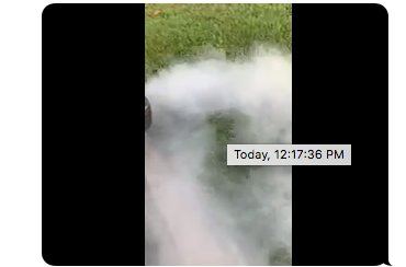

    @MR Derick If you're truly not losing any coolant i second this opinion. I had a 4.3 Astro van with bad valve oil seals and it smoked as bad on start up as your picture shows. I was able to change those seals with the heads still attached ... but that's a Chevy so I don't know about the toyota motor

    Did this start suddenly or was it a slow progression?

    It started suddenly about 2 months ago. The only fluids I seem to use a lot of is gas and oil. Most of the oil comes from a new leak and the oil in the air box. I also believe could be blow by.

    There's only 3 fluids in an engine. Oil, gas, water. Of which to much gas makes black smoke. Burning water makes pure white steam. Burning oil makes white smoke with a hint of blue in it. So Its either oil or water. Since you changed the PCV valve, I know since I read the whole thread before posting, but have you checked the vent on the opposite side of the engine? PCV allows intake vacuum to suck from the crank case but new air needs to be let in. Normally through a vent cap on the valve cover. Maybe clogged?? Typically, as others have said, smoke on startup is valve seals, but that typically doesn't start suddenly, would be slow progression.

    Good videos. Here's what may be happening on your truck- a small HG leak causes the coolant to enter the cylinder when the engine is shut down. Remember, the cooling system is still under pressure, and nothing else is at this point. It causes the coolant to burn on startup. Then as the engine heats up, the gasket seals a bit more, and white smoke is gone. When engine is shut off, it repeats. This could be the early stages of HG failure.
    Like in the video, pull some plugs and check it out.

    Thank you all for your input. I'm not a mechanic or do I play one on tv. This has weighed on my mind for a while and have no solutions. It's mindblowing how much smoke come out every morning and after work. I bought a new pcv valve from Toyota today and will install in the morning. Stay tuned.........and I will try some of your suggestions.
